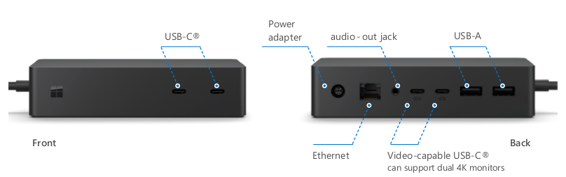

    Surface Dock 2
    Loosing Ethernet connectivity with Microsoft Dockingstation USB-C Travel Hub on W10 1909 x64 surface-dock2.png
    Tech Specs
    [table][tr][td]Compatibility[/td] [td]Surface Book 3 (13.5” and 15”) Surface Pro 7 Surface Pro X Surface Laptop 3 (13.5” and 15”) Surface Go 2 Supports dual 4K monitors at 30Hz: Surface Pro 6  Surface Pro (5th Gen) Surface Laptop 2 Surface Laptop (1st Gen) Surface Go Surface Book 2 (13.5” and 15”) Not compatible with: Surface Pro 4 Surface Pro 3 Surface Book (1st Gen)[/td] [/tr] [tr][td]Dimensions[/td] [td]5.12" x 2.75" x 1.18" (130 mm x 70 mm x 30 mm)[/td] [/tr] [tr][td]Weight[/td] [td]1.13 lb (515 g)[/td] [/tr] [tr][td]Connections[/td] [td]199W power supply Supports dual 4K at 60Hz Surface Connect cable (80 cm) 2 front-facing USB-C® (10 Gbps) (15W) 2 rear-facing USB-C® (10 Gbps) video display enabled (7.5W) 2 rear-facing USB-A 3.2 (10 Gbps) (7.5W) 3.5mm in/out audio jack 1 gigabit Ethernet Security lock support (Kensington compatible)[/td] [/tr] [tr][td]Warranty[/td] [td]1-year limited warranty1[/td] [/tr] [/table]

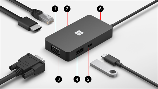

    Surface USB-C Travel Hub for Business
    Loosing Ethernet connectivity with Microsoft Dockingstation USB-C Travel Hub on W10 1909 x64 4560778_en_8.png
    Tech specs
    [table][tr][td]Compatibility (Computers)[/td] [td]Modern PCs with USB-C® port All Surface devices with USB-C® port[/td] [/tr] [tr][td]Dimensions[/td] [td]3.5" x 1.9" x 0.59" (89 mm x 48 mm x 15 mm)[/td] [/tr] [tr][td]Colors[/td] [td]Black[/td] [/tr] [tr][td]Product feature performance[/td] [td]1 USB-C® 3.2 Gen 2 port (10 Gbps data transfers and pass-through accessory charging) 1 USB-A 3.2 Gen 2 port (10 Gbps data transfers and pass-through accessory charging) 1 Gigabit ethernet port 1 HDMI 2.0 port with 4K (60Hz) video out support 1 VGA port  Note: Supports compatible accessory charging. Does not support laptop charging. Connector plating: Nickel plating Advanced features: Support for Android USB Power Policy HDMI priority CFU firmware update[/td] [/tr] [tr][td]Weight[/td] [td]0.22 lb (99.2 g)[/td] [/tr] [tr][td]Compatibility (OS)[/td] [td]Google Chrome OS 73.0.3683.88 Google Chrome OS 76.0.3809.136 Windows 10 Home Windows 10 Pro Windows 7 Professional Windows 8 MacOS 10.14.1 MacOS 10.14.6 MacOS 10.15.1 Android 9.0.0 Android 8.1.0[/td] [/tr] [tr][td]Connection interface[/td] [td]USB-C® captive cable with 200mm cable that stores in the end of Travel Hub[/td] [/tr] [tr][td]Warranty[/td] [td]1-year limited warranty1[/td] [/tr] [tr][td]Technology details[/td] [td]High-speed data transfer and pass-through charging for your accessories with the USB-A and USB-C® 3.2 Gen 2 ports, with up to 10 Gbps transfer speeds.  Gigabit ethernet connectivity for faster internet speeds. Plug in to a single monitor at your desk with HDMI 2.0 port, with video resolution up to 4K with 60 Hz refresh rate, better than most other portable, compact hubs on the market. Project on the big screen through the included VGA port for even more video-out compatibility.[/td] [/tr] [/table]
