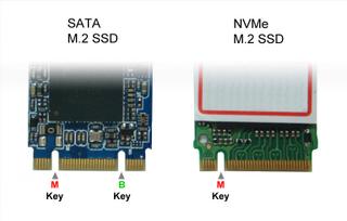

  2. M.2 NVMe/SATA
    Yeah... except a few NVMe M.2 drives that have both keyes... like this LiteOn drive (LINK) or Intel Optane 16/32GB.
    There are also AHCI (not NVMe) M.2 drives, that use M-Key only (Samsung XP941 or some SM951 models).
    M.2 is basicly a minefield :
    Some early boards don't support "SATA" type M.2s, and some laptops don't support M-Keyed ones.
    Only one drive support Legacy booting (by default), however most M-key ones require (U)EFI modding for booting to work on Sandy Bridge or later platforms.
    agent_x007, Nov 15, 2018

  4. M.2 SATA to NVME clone: Windows 10 won't boot
    M.2 NVMe/SATA
    M.2 SATA to NVME clone: Windows 10 won't boot m2-sata-nvme-ssd.jpg
    sata has the 2nd "B" keys as well, as the "M" key slot.
    jboydgolfer, Nov 15, 2018
