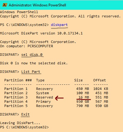

  3. Windows Update Error 0xc1900104
    You can see the size of the MSR (Microsoft System reserved) partition in a Command Prompt or in PowerShell...
    DiskPart
    Select Disk 0
    List Part
    Exit
    Windows uses 16 MB these days, but a larger size (124 MB, IIRC) might be a holdover of a previous version. That would be OK. I doubt your MSR is the problem. The size of your Recovery Partition looks a tad odd to me - too big to be Microsoft, somewhat small
    to be OEM. But let's duck the issue for now.
    Major problem with Windows Update stuck at 61% with error 0xC1900104 6b345386-e98b-4f99-99f3-0b6223995fdc?upload=true.jpg
    To do as MarkW suggests, go here...
    Download Windows 10
    Download Windows 10
    That will lift you to version 1803. See the screens here...
    How to Upgrade to Windows 10 Version 1803 Spring Creators Update Using ISO File from Versions 1709, 1703, 1607, 1511 or 1507
    PCR Just PCR, Mar 2, 2021
