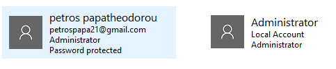

    Hello, I want to make administrator the windows account that I use. Right now there are 2 accounts in the system: mine and an account named "Administrator" that I created by mistake. When I go to Control Panel\User Accounts\Manage Accounts, it shows my account as administrator as you can see.
    Make my account administrator 061a0f52-684c-487d-baf9-8f5d785b5a50?upload=true.png
    But it is not an administrator account! It still requires permission to rename files inside C:\Program Files and I cannot extract anything in there because it says access denied. If I double click on my account and choose "change account type" I cannot select administrator because it is grayed out and I cannot delete nor change the account type of the other "Administrator" account! How can I be administrator in my own pc?!

  3. Deleting an administrator account
    Hi Imat,
    Kindly follow the steps below to resolve this concern:
    Step 1: Remove pin from your administrator account. Here's how:
    • Log in the administrator account.
    • Go to Settings.
    • Select Accounts.
    • Go to Sign-in options.
    • Under PIN, click on Remove.
    • Tap Remove to confirm.
    • Type in your administrator password to verify.
    • Hit OK.
    Step 2: Make your local account as an administrator account by following the steps below:
    • Log in your local account.
    • Go to Settings.
    • Select Accounts.
    • Go to Family & other people.
    • Select Change account type.
    • Under Account type, select Administrator.
    • Hit OK.
    • Restart your computer and sign in with your administrator account.
    Step 3: Remove the old administrator account. Please follow the steps below:
    • Log in the new administrator account.
    • Go to Settings.
    • Select Accounts.
    • Click on the admin account you want to remove and hit Remove button.
    • When you see a confirmation dialog, select Delete account and data.
    Hope this information helps. In case you need further assistance, kindly reply to us.
    Charianne Per, Aug 27, 2019
  4. NavyLCDR Win User
    Weird account name and lost Administrator rights.
    Well, I know what I would do.
    Under Settings, Accounts, Family & other users, then under Other users, add someone else to this PC. Then click the link for "the person I want to add doesn't have an email address". Then click the link for "Add a user without a Microsoft account". Then enter a temporary user name like TempAdmin. When the account appears in the Other Users list, click on it. Click change account type. Make the temporary account an Administrator.
    Log in as the temporary administrator account, and copy all the files you want to keep from both the Andrius folders under Users to the temporary account's folder. Then delete whatever Andrius users are listed under settings, accounts. Go back to the Users folders and delete any remaining Andrius folders in there. Reboot the computer, log in as the temporary administrator and recreate an Andrius account using the exact same steps you made the temporary account - you can convert it to a Microsoft account if you want later.
    Then do the rest of the steps to copy all your files back and delete the temporary administrator account.
    NavyLCDR, Aug 27, 2019
