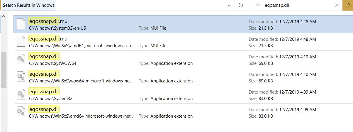

    C:\WINDOWS\system32>sfc /SCANFILE=C:\Windows\System32\eqossnap.dll
    "Windows Resource Protection found corrupt files but was unable to fix some of them."

    CBS.log says that these are bad:
    cmi2migxml.dll
    mobsync.exe
    netcorehc.dll
    eqossnap.dll
    netcorehc.dll
    WSDPrintProxy.DLL but I never use any printer
    WWanHC.dll
    PNPXAssoc.dll
    Can I manually fix/replace them? I do not have another, healthy PC with Win10 to get replacements from. Why can't I simply get individual replacements from Microsoft online?
