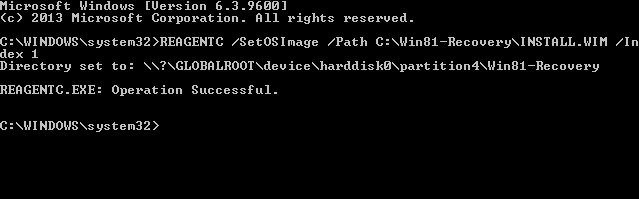

  2. Unrecognized partition error
    mbr2gpt error: Unrecognized partition found, index 2 [​IMG]
    Try this method but no success. And also usb media already contains install.wim file of about 3.5 gb.
    PS C:\WINDOWS\system32> REAGENTC /SetOSImage /Path C:\Win10-Recovery\INSTALL.WIM /Index 1Directory set to: \\?\GLOBALROOT\device\harddisk0\partition1\Win10-RecoveryREAGENTC.EXE: Operation Successful.PS C:\WINDOWS\system32> REAGENTC /InfoWindows Recovery Environment (Windows RE) and system reset configurationInformation: Windows RE status: Disabled Windows RE location: Boot Configuration Data (BCD) identifier: 42d7ea6a-31f3-11e7-a748-fa207b40608d Recovery image location: \\?\GLOBALROOT\device\harddisk0\partition1\Win10-Recovery Recovery image index: 1 Custom image location: Custom image index: 0REAGENTC.EXE: Operation Successful.PS C:\WINDOWS\system32> mbr2gpt /convert /allowfullOSMBR2GPT will now attempt to convert the default book disk.If conversion is successful the disk can only be booted in GPT mode.These changes cannot be undone!MBR2GPT: Attempting to convert disk 0MBR2GPT: Retrieving layout of diskMBR2GPT: Validating layout, disk sector size is: 512 bytesCannot find OS partition(s) for disk 0PS C:\WINDOWS\system32>
