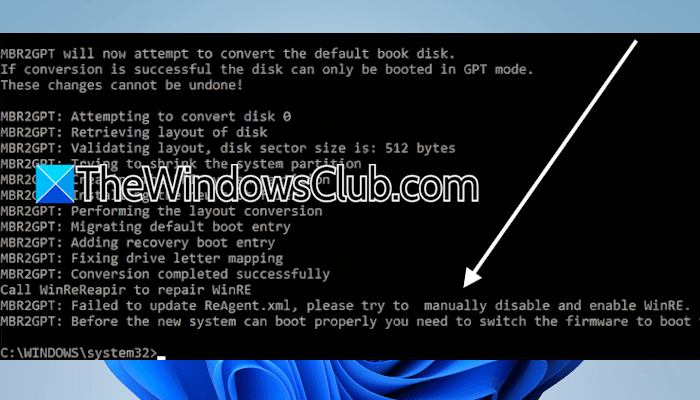

    MBR2GPT Failed to update reagent.xml on Windows computer MBR2GPT-Failed-to-update-reagent.png ​
    MBR2GPT is a command-line utility in Windows computers used to convert an MBR disk into a GPT. The best part of this utility is that it converts an MBR disk into a GPT disk without erasing the data. Some users are getting the error “MBR2GPT Failed to update reagent.xml” while using this tool. This error […]

    Can't boot after running mbr2gpt
    Seems your Recovery partition in your original build may not be properly configured. However, this seems to be a problem some experience. See: MBR2GPT Failed to Update ReAgent.xml on Windows 10? [Full Fix] - after the alternative approach suggested (use Minitool) there are more suggestions.

  3. MBR2GPT
    if it states 'enabled'
    please try this:
    in an elevated command prompt
    run
    reagentc /disable
    & if this is successful
    run
    reagent /enable
    if this is succesful also
    try
    MBR2GPT /validate /allowfullos
    to verify if the issue is resolved a you're ready to go for the conversion
    Erik Moreau, Jul 11, 2026
  4. jds21 Win User
    I just did step one and they have just all installed.... thank you so much.... it was quite frustrating having that update window pop up every 5 minutes and failing to instal every time
