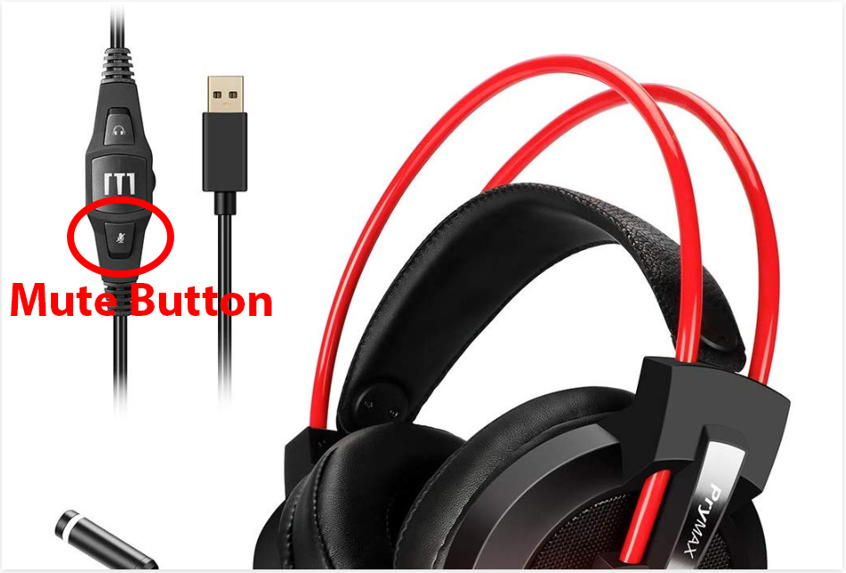

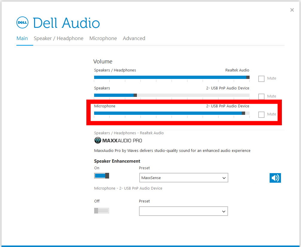

    I have three different brands of USB Headsets with Microphone and Mute Button Wired and Wireless all with the same behavior as follows:
    1. If the Mute checkbox shown below is UNCHECKED and the microphone's mute button on the headset is toggled on and off the microphone is muted by the headset's microphone internal circuitry which does successfully mute the sound to the record capture,
      however it does not update the mute checkbox in system settings for the USB microphone device.
    2. If the Mute checkbox shown below is CHECKED then the Headset's Microphone Mute button has no effect what so ever.
    NOTE: There isn't any Win32 API solution that I can figure out or find to solve this sync problem and apparently NAudio's solution can not address the problem either because the Windows API in it's redesign of the mixer
    never considered this scenario of bidirectional syncing between the USB device driver and the OS.
    I will try to give an example of how this can be an unsolvable problem the best I can. I am working on a voice driven program for the blind and I can't expect them to be able to turn off a checkbox in settings no more than I can have a visual queue
    showing them if the microphone is on or off. The only feedback I can give is sound effects and the computer talking to them.
