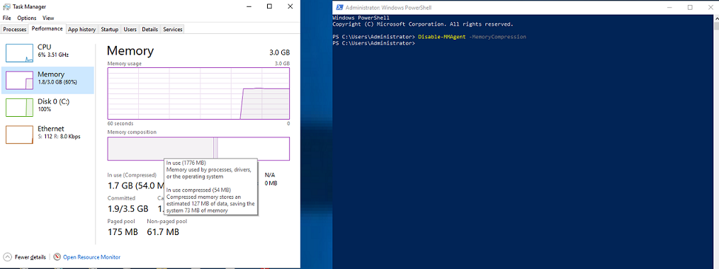

    Memory compression is enabled by default. However, it appears for whatever reason, you currently have it disabled. Within a Administrator PowerShell command prompt type the following command to disable memory compression
    Disable-MMAgent -MemoryCompression

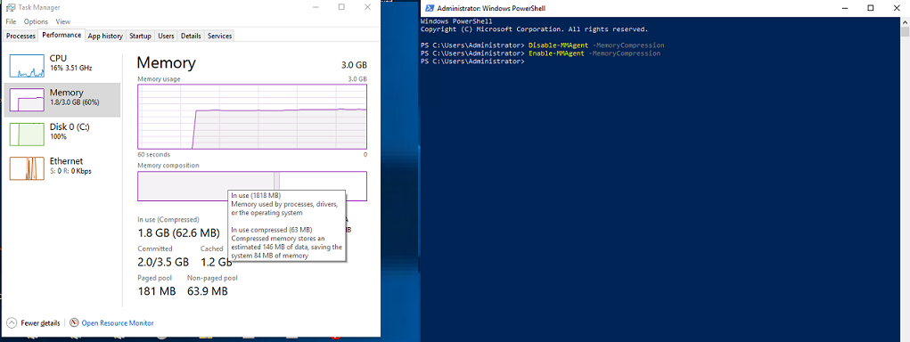

    Within a Administrator PowerShell command prompt type the following command to enable memory compression
    Enable-MMAgent -MemoryCompression

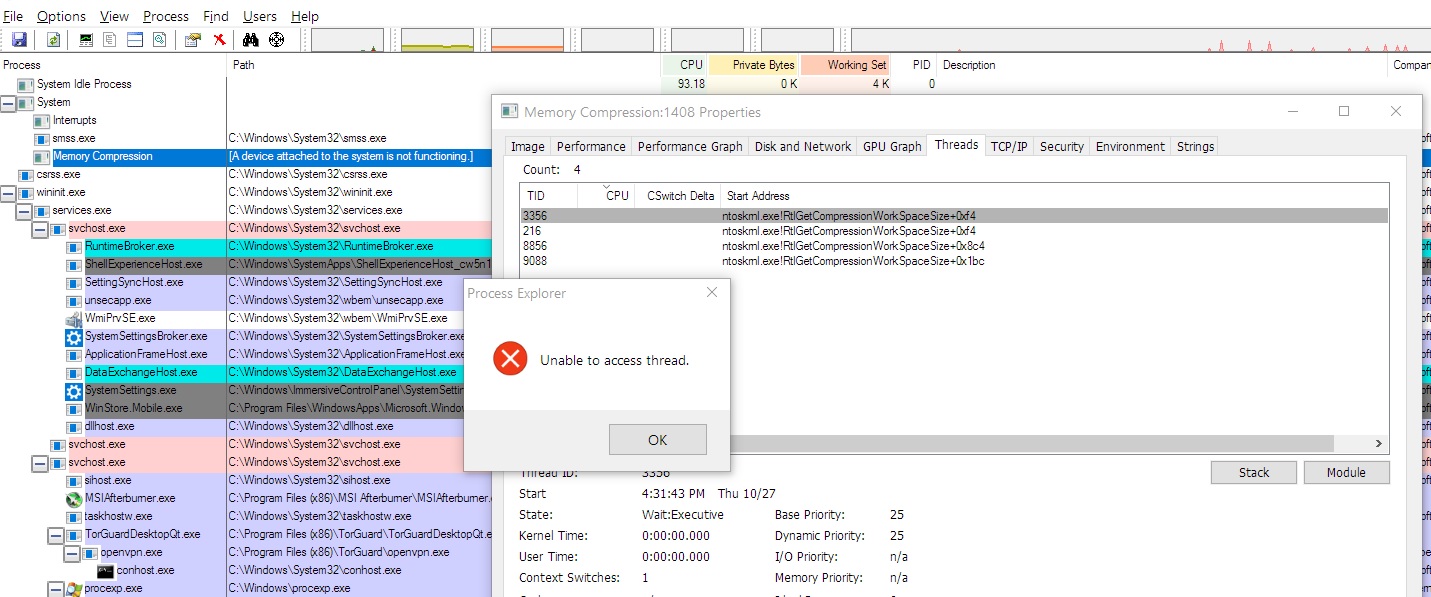

    If I enable memory compression (via the mmagent cmdlet in powershell) I get this "error" in process explorer about a process called "memory compression" and the path reads "[a device attached to the system is not functioning.]":
    When I try to access any kind of information on it via properties settings, which there is none, it says "Access Is Denied" the only info I can see is threads tab that shows "ntoskrnlGetCompressionWorkspace" error.

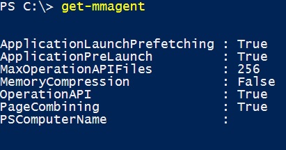

    Anyways, if I disable memory compression via the mmagent cmdlet in powershell, I no longer get the "error" in process explorer! The image below shows that memory compression is disabled with its "False" value:
    But the other features having "True" values show that superfetch/prefetch is currently enabled. Normally superfetch enables memory compression by default when superfetch is on, until I manually disabled memory compression.

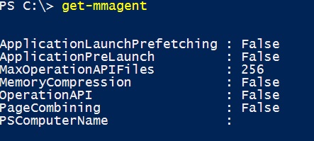

    Suppose Superfetch (and memory compression) was enabled before then I disabled the Superfetch service in Service Manager, well this is what the mmagent cmdlet in Powershell looks like.
    With Superfetch disabled, it also disables memory compression.
