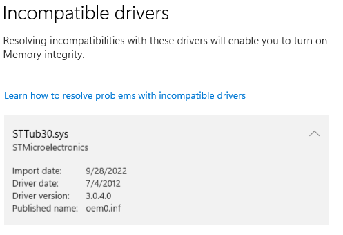

    My attempt to enable the Memory Integrity security feature also failed:
    Memory integrity forced off "incompatible driver" STTub30.sys 8be0905d-c28b-46e1-9faa-9279fdcff618?upload=true.png

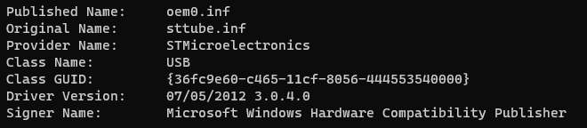

    Open a command prompt as admin. Locate the provider name and verify the *.inf information matches the detail from the original attempt error message to enable memory integrity.
    pnputil /enum-drivers
    Memory integrity forced off "incompatible driver" STTub30.sys fe933189-c846-4385-8ba3-bbfb21362673?upload=true.png

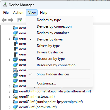

    My pnputil command failed above so I next tried Device Manager (Win-X, Device Manager):
    Memory integrity forced off "incompatible driver" STTub30.sys d3359b9d-ef54-4833-ba62-7bd80eb47aef?upload=true.png
    1. From the View menu enable the "Show hidden devices" feature then "Devices by driver."
    2. Right-click on the *.inf corresponding to your issue and select remove.
    3. Reboot
