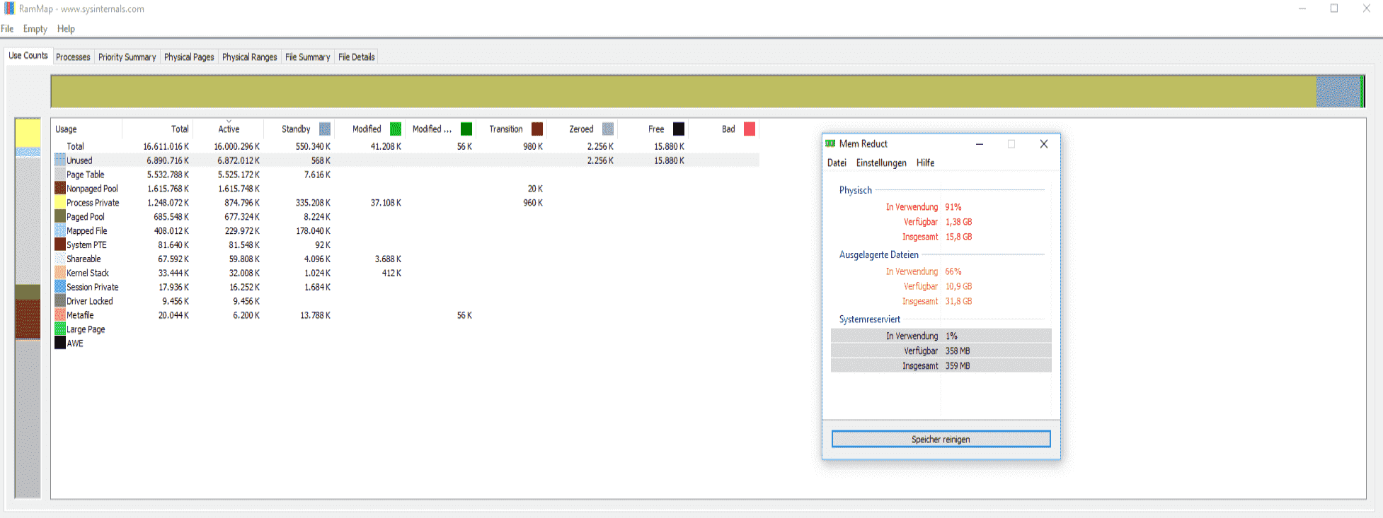

    I am running an Intel i7 with 16 GB physical RAM on a gigabyte UD99x mainboard (Nvidia 970, Bitdefender 2018). After having the computer running for less than an hour, my memory usage is in the 95-99% range, but the applications/processes amount to max. 5-6 GB RAM. After reading about RAMMAP in this forum, I used it to understand where the memory is going to, as I couldn't identify a single process/app to cause the issue.
    It seems that my PC doesn't release its "Unused" memory, at least that is what I have figured from the RAMMAP picture (I am not an expert, sadly).
    Memory problem with unreleased "Unused" memory 881d2f20-5531-4f61-a79e-a656f22bbb51?upload=true.png
    If I use RAMMAP's "empty" features, I can release 10% or so, but those components are quickly used again - moving my RAM usage back to 99%.

  3. philc43 Win User
    Memory Problem
    I notice you have a Killer network Manager in your list. There have been problems with the Windows Network Data Usage Monitoring Driver service which in combination with a Killer network driver starts to fill up the Non-Paged Pool memory. This was in W8.1 and the suggested fix is altering the registry key value of the “Start” entry to 4 in HKEY_LOCAL_MACHINE\SYSTEM\ControlSet001\Services\Ndu\ to disable the Windows Network Data Usage Monitor Driver from starting.
    See https://bluebluewave.wordpress.com/2...ge-monitoring/
    Worth a try in your system I would think.
