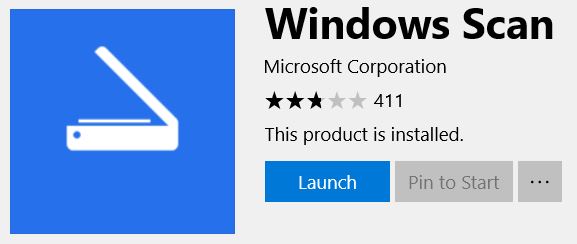

    Unable to scan, printer says waiting for computer, scan to not working and start scan not working. test of device is functioning per computer. Error message says scanner is not installed as part of version with update. My printer is hp laser jet 3030 (3015/3020/3030). I have a disk for the original install with complete, but that has not worked since whatever update changed to windows fax and scan.

    • Are you using the built-in Windows Fax and Scan app? Or are you using other app or program to scan?
      • Built-in, allegedly workable with Windows 8.1 and above.
        MFP printer: scanner will not work after windows update, but computer test shows ok. 0f4b42b2-cb86-4373-978b-164fc4e1f797.jpg
