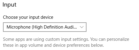

    The input device is showing properly:
    Microphone detected but no input sound 1f42e4f0-06f0-4264-8580-67989a20adc8?upload=true.png
    Windows even detects when I connect it to the front or the back jack. So it's being detected properly.

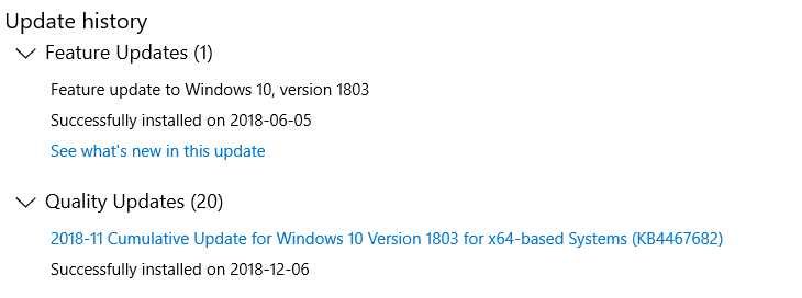

    - Installing the 2018-11 Cumulative Update for Windows 10 Version 1803 for x64-based Systems (KB4467682)
    Microphone detected but no input sound 8a505e67-ef46-47fe-820e-bc0c79d1ecea?upload=true.png
    Still not working...
