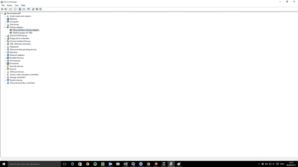

  4. Nigyu Win User
    Microsoft basic display adapter not loading
    Microsoft Basic Display Adapter
    The scenerio is:
    I have a dual monitor setup in my workstation. Since the upgrade to windows 10 from 7, one of my monitor doesnt work.
    I have two nvidia quadro fx 1800 graphic cards. However only one of them appear on the device manager as seen in the screenshot.
    Microsoft basic display adapter not loading 721d85d7-f133-467c-914e-49ae614b635a.png
    The other one is Microsoft Basic Display Adapter which has its own issue.
    Device Status:
    This device is not working properly because Windows cannot load the drivers required for this device. (Code 31)
    The driver trying to start is not the same as the driver for the POSTed display adapter.
    Trouble shooting procedure,
    Updated the drivers.
    Changed the graphics card hardware.
    Uninstalling the Microsoft Basic Display Adapter and reinstalling with the smae message. Updating the driver but the confirmation message being updated.
    What are my other options?
    Nigyu, Jul 17, 2018
