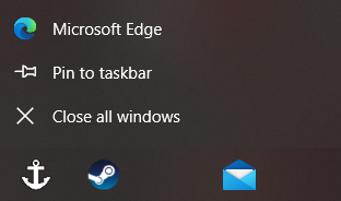

    Hello, my computer forced me to update today and when i opened it it decided to bring up Edge n it wouldn't leave until i closed it with task manager.
    Then unpinned it but there was a space still there. and sure enough, when i right click that "free" space Microsoft edge is there and i can't unpin it.
    Microsoft edge pinning itself invisibly to my taskbar. 291766e8-634b-47e7-bb18-619eb9f8252b?upload=true.png
    Why do this? When i restart it's back where it was before as if I'd never unpinned it.
    FyreFirefox, Aug 28, 2020

    It's possible that you're not able to pin Edge to the taskbar due to some corrupted system files. We'd like to learn more about your concern so that we could provide the proper resolution. We just have a few questions for you:
    • Which build version of Windows 10 is currently on your computer? To check, click
      Start, type winver, and press Enter.
    • Does this only happen to Edge? Have you tried pinning other apps to the taskbar?
    • What are all of the troubleshooting steps that you've done? Please list all of them so that we could move on to the next steps.

    Thank you for posting your query in Microsoft Community. I understand the issue that you are facing currently, and we in Community will try to resolve your issue the best way we can.
    I would like to suggest that you follow the steps below to resolve your issue:
    • Go to task manager. (To open press ctrl+alt+delete)
    • Click on Details, select explorer.exe and click End Task.
    • Go to file, located on the top left corner of task manager
    • Type explorer.exe and click on OK.
    Try to pin Edge to taskbar and check if the issue still persist.
    Hope this information helps and let us know the status of the issue we will be glad to help you further.

    We appreciate the information you've provided. The latest build for version 1703 is 15063.483, so if you don't have the latest build installed, we suggest installing them by going to
    Settings > Update & Security > Check for Updates.
    This could also happen if you have any programs that modify how Windows normally looks that might override the Pin to Taskbar function. To find out if any other programs are preventing you from pinning Edge to the taskbar, perform a clean boot. This will
    load Windows with minimal drivers and programs, minimizing the risk of software conflicts. Check if you could pin Edge to the taskbar while in a clean boot environment by following the steps
    here
    Note: To return your computer back to normal, check the section How to reset the computer to start normally after clean boot troubleshooting.
    We'd also recommend creating a new user profile to check if this is caused by a corrupted user profile. You may find the steps for doing that through this link.
    Let us know if you're able to pin Edge to the taskbar after following these steps.
