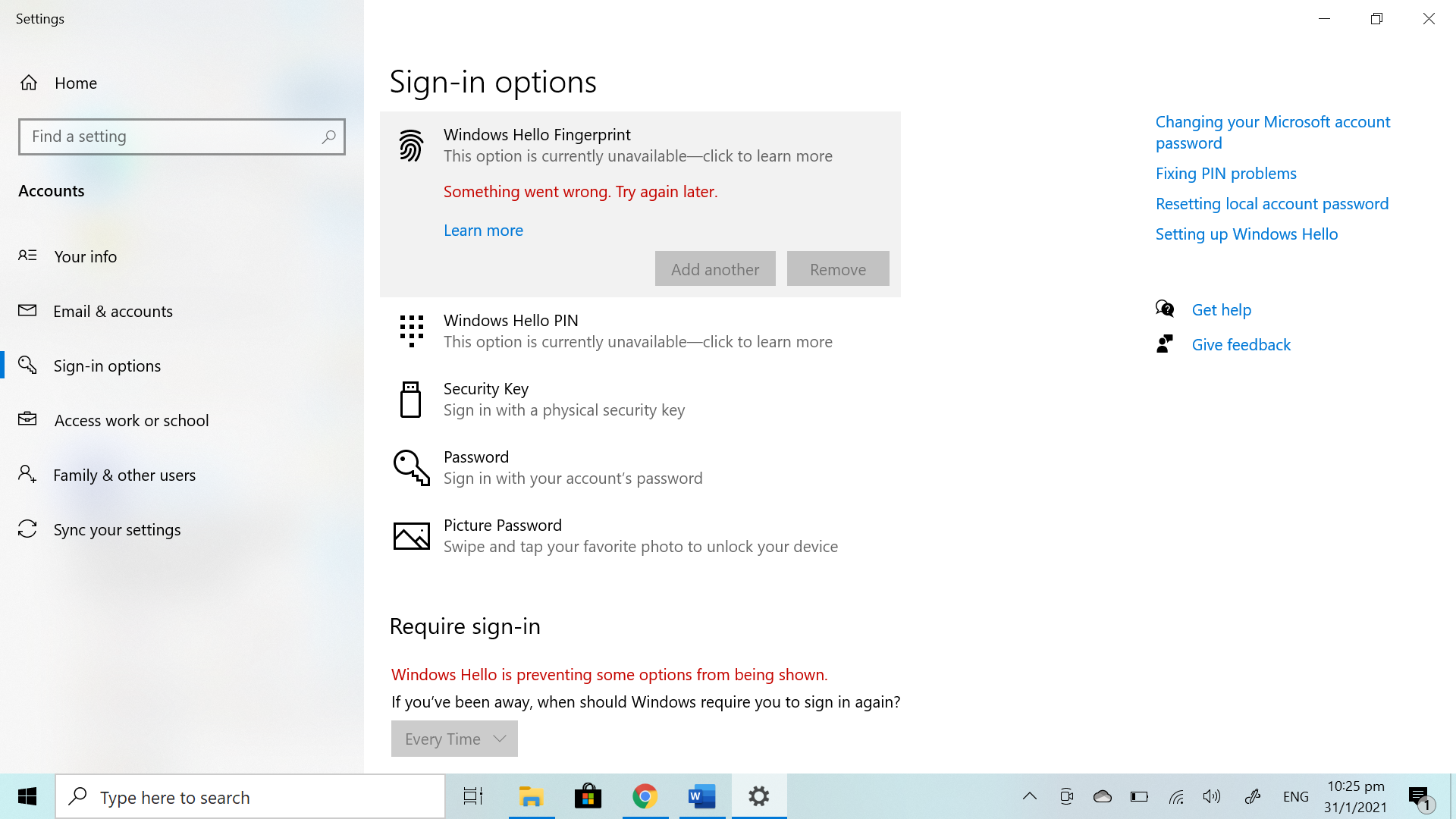

    Good day,
    I have a 1 day old laptop, and am facing issues with Microsoft Hello, as shown below.
    Please assist!
    Microsoft Hello on My New Laptop Stopped Working ca614fec-15b3-4e9d-b8cf-b90d289b82c7?upload=true.png
    KChiang8589, Jan 31, 2021

  4. Nikhar_K Win User
    Hello stopped working
    I understand that you are unable to use Windows Hello face on your Surface Laptop 2. I’ll certainly assist you with the issue.
    However, please let us know:
    • Are you aware of any changes made to the computer prior to this issue?
    • Which build version of Windows 10 is installed on the computer? To check type:
      winver in the search bar on the Taskbar and hit
      Enter.
    Let us try a couple of troubleshooting steps and check:
    Reset Biometric Database:
    Try resetting the Windows Hello Biometric Database and check if that helps. Please follow the steps mentioned below:
    1. Press Windows logo key + R, to open
      Run dialog box.
    2. Type services.msc and click on
      OK
    3. Look for Windows Biometric Service, double click on it and click on
      Stop.
    4. Now, go to C:\Windows\System32\WinBioDatabase, take a backup of all the files inside the
      WinBioDatabase folder.
    5. After taking a backup of the files, delete all the files.
    6. Now, open Services by following step 1 and 2, and restart the
      Windows Biometric Service.
    7. Go to Start >> Settings >> Accounts >> Sign-in options and register the Face data again.
    If the issue persists, refer the steps mentioned below:
    1. Press Windows logo key + E, to open
      File Explorer.
    2. Navigate to C:\Windows\System32\WinBioPlugIns\FaceDriver.
    3. You will find two files, HelloFace.inf and
      HelloFaceMigration.inf, right click on each file and select Install.
    4. Restart the computer.
    Let us know how it goes.
