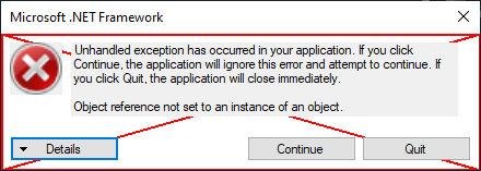

    I was updating GeForce Game Ready Driver. About when the update finished installing, the following error message appeared.
    Microsoft .NET Framework Error UI Bug? d9e67036-c289-47d5-9dc9-4313cc8ca6dd?upload=true.png
    The error isn't really the issue. I'm more concerned with how weird the message window looks. It looks so fake. I didn't click any of the buttons, just moved the window away. Then I proceeded to close everything and restart my computer. So far there are no further issues, but I want to know. Was this a UI bug? Or should I be concerned?

    I suggest you to un-check and recheck .Net framework 3.5 and .Net framework 4.6 advance series from Windows features.
    Try the following steps:
    • Press Windows + R keys to open Run command.
    • Type Appwiz.cpl and select "turn Windows feature on or off" from the left
    • Uncheck .Net framework 3.5 and .Net framework 4.6 advance series.
    • Restart the computer
    • Repeat step 1 and 2 and check .Net framework 3.5 and .Net framework 4.6 advance series.
    • Restart the computer.

    Basically, to sum up what I can tell:
    -The application(s) that crashed use .NET Framework 2.0 or 3.5.
    -First error is it getting nothing when it expected something (not very telling).
    -Second error occured in "System.Data.SQLite" which is not .NET Framework. I repeat, not .NET Framework.
    -SQLite is is a GNU licenced, free to use library.
    -Any .NET-compiled service or process could be causing the error. If you watch the Task Manager, you might be able to tell which process closes after you click on "Quit."
    I suggest you search your computer for sqlite*.dll. Whatever programs it is found in close proximity to are most likely the culprits for the crashes.
