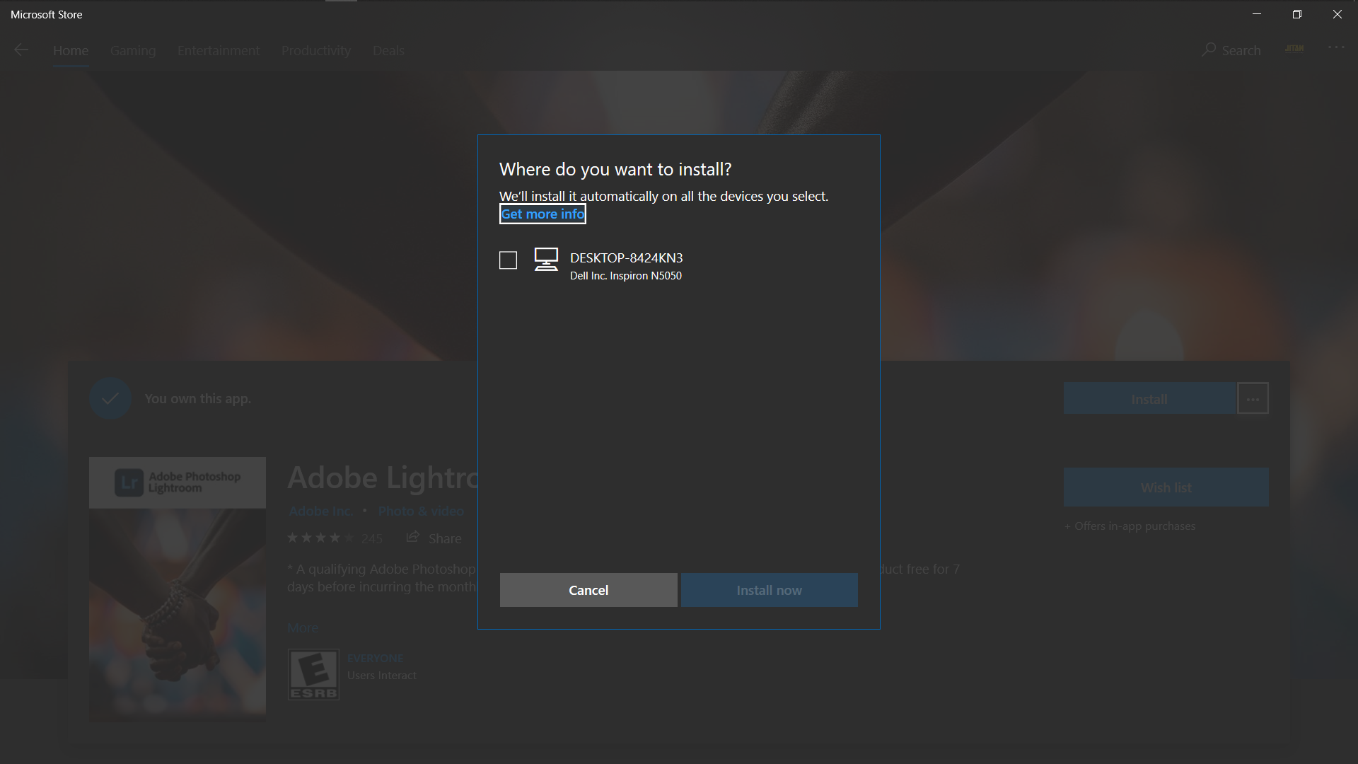

    I tried to install any app from Microsoft store and it's not working.
    I then figured that my PC is not visible in the list. The PC shown is mu old PC that i am no longer using.
    How can i fix it? Or add back my PC to the list?
    And is it why i cant install any app?

  3. Apps won't install in Microsoft Store
    We understand your concern as you are unable to install apps in Microsoft Store. In order to get clarity and to assist you accordingly, please reply with the answers
    to the questions below:
    • Do you have any non-Microsoft antivirus program installed?
    • Does this issue occur for all apps from the store?
    • What is the date and time on the PC and ensure it is correct?
    Meanwhile,
    we would suggest you to perform these steps and after every step check if you are able to install the app.
    Step
    1:
    Reset the Windows Store Cache: Press the Windows
    Logo Key + R
    to open the Run
    dialog box, type wsreset.exe, and then select OK.
    Note:
    A blank Command Prompt window will open, and after about ten seconds the window will close and Microsoft Store will open automatically.
    Step 2: Run the Windows Store Apps Troubleshooter: Select the
    Start button, and then select Settings>Update & Security
    > Troubleshoot, and then from the list select Windows
    Store apps
    > Run the troubleshooter.
    Step 3:
    Refer the troubleshooting steps and mentioned
    in this article: Fix
    problems with apps from Microsoft Store
    Step 4: If you have any non-Microsoft security/antivirus software installed, disable it temporarily and
    then try installing the game.
    Step 5: If the issue persists, then we would suggest you to create a new administrator user account and
    check, refer this article to create
    a local user or administrator account in Windows 10
    Aditya Roy
    Aditya_Roy, Feb 25, 2021
