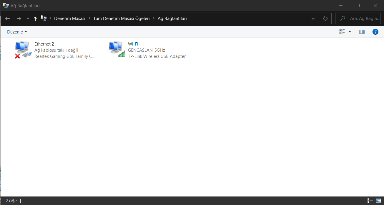

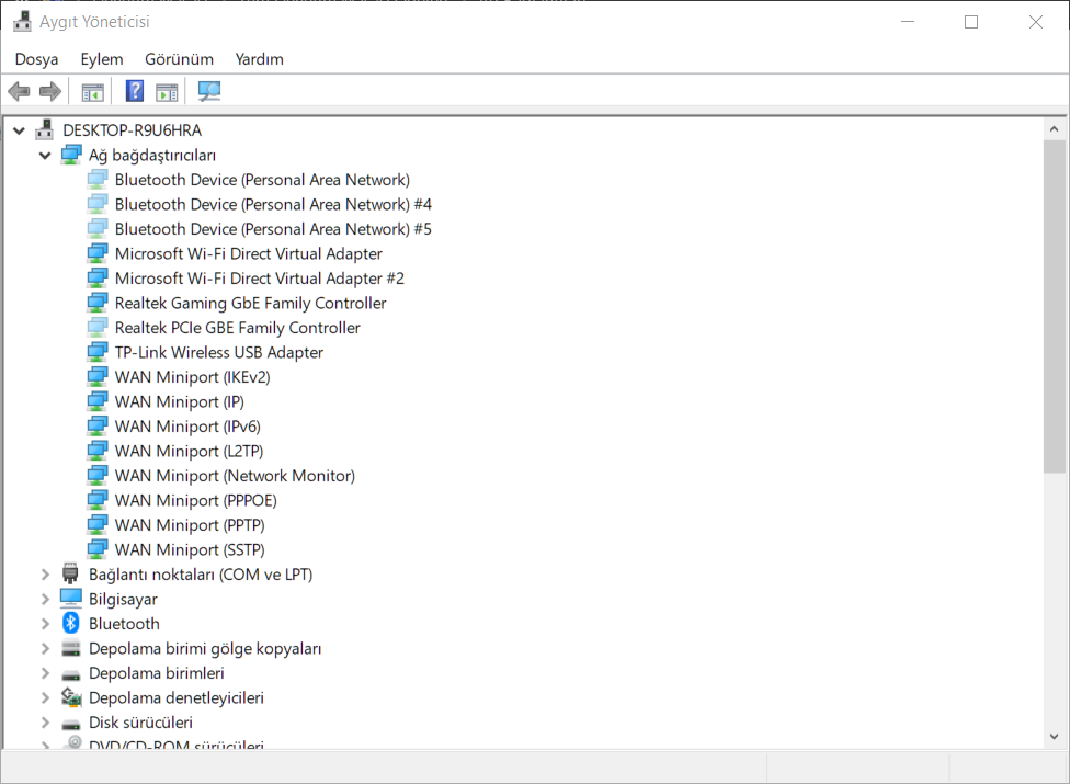

    I have a weird problem with Microsoft WiFi Direct Virtual Adapter, it shows in device manager & it doesn't have any marks on it Microsoft WiFi Direct Virtual Adapter problem efa5ed91-dffd-4093-adb8-d15dd02e045e?upload=true.png but it won't show in network adapters, Microsoft WiFi Direct Virtual Adapter problem edfe4c53-1d58-4f5d-994d-54f6321e72d9?upload=true.png i tried sfc & deleting hosted network... Registry key but no luck.
