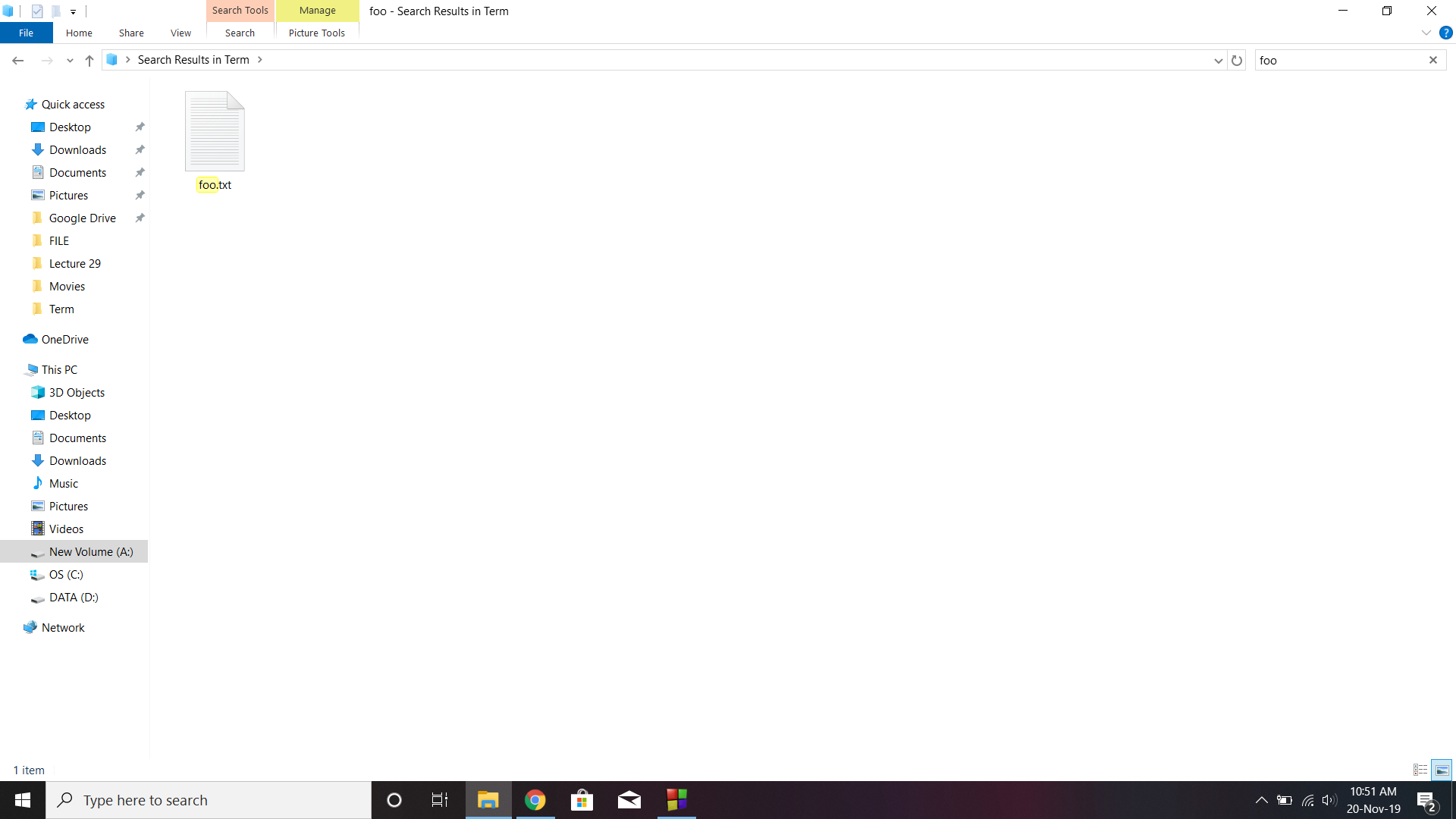

    Category: Minor
    Details: When permanently deleting a file from a folder, the name of that deleted file vanishes at once. However, if a file name is searched from the search bar and after it is found, deleting it permanently does not remove the name of that file until the current window is refreshed.
    Minor bug[Permanently deleting a searched folder does not remove the name of that folder... 28439407-863d-46c2-a434-1950b6b6532a?upload=true.png

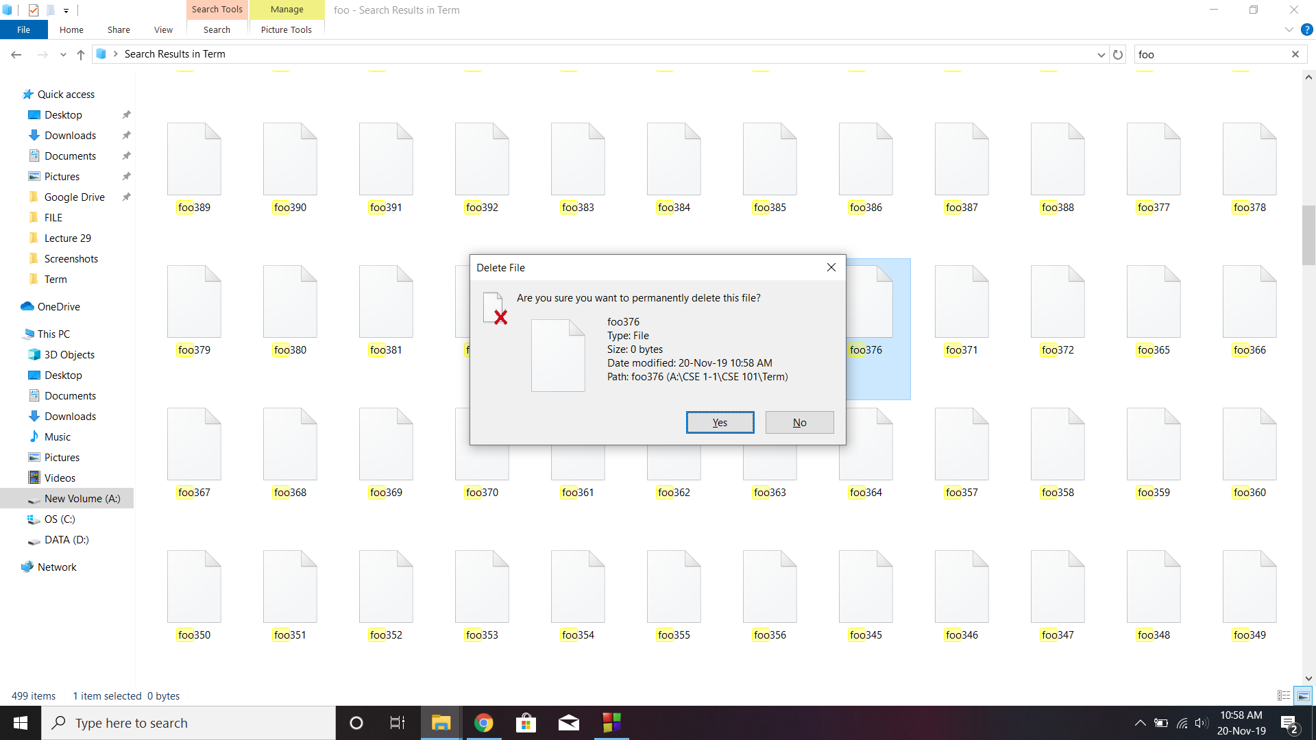

    I've created the file foo.txt in my folder. I searched for it and the result popped out. If I click that folder and hit Shift+Delete, the file will be permanently deleted and should no longer appear in my search list. However, it does appear until I refresh the page. The bug is not troublesome if the search list contains a file or two, but becomes very annoying when there are multiple files like below:
    Minor bug[Permanently deleting a searched folder does not remove the name of that folder... 38e90c03-b707-4e13-b977-5030bcd8b518?upload=true.png
    Each time I delete a file, the name does not vanish at once(which is very unhelpful for keeping track of my non-deleted files) and I have to manually refresh the window in order to do that.
    I hope the support team should look forward to this matter.
