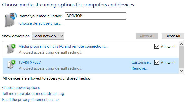

    DLNA services has to be explicitly enabled on a Windows 10 PC by opening the Control Panel > Networking and Sharing Centre > Media streaming options (on the left panel) > Turn on media streaming (button).
    Mirroring Desktop on PC Windows 10 to a smart TV via ethernet cables network. 6514f344-8447-48e8-89ff-29fc81b01e9c?upload=true.png
    On the media steaming options window (screenshot above), enter a name for the user's library folders on the PC and allow access to the TV-name appearing under the devices list on the Local network.
    If the TV-name does not appear, first ensure that both the TV and PC are connected to the same local network. Then use the Cast to Device menu on any MP4 file to register the TV-name within the Devices list of Windows Settings and also to show up on the Media
    streaming options window.
    Once enabled, DLNA services will automatically start everytime the PC is powered ON. To disable DLNA you need to open the Services applet by calling Run dialog (WinKey+R) and then entering services.msc in the dialog > scroll down
    on the Services applet and double click on "Windows Media Player Network Sharing Service" to open its Properties window > Stop the Service by clicking on the Stop button > change the Startup type to "Manual" from the drop-down > click OK and close the Services
    applet.
