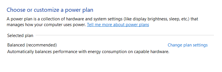

    MISSING POWER PLAN - Can only create a 'Balanced' power plan
    Hi, I've had this problem for a while but thought I'd finally post a question. I have a Dell XPS 15 9570 and windows 11, and while I am trying to create a 'high performance' power plan, the option just doesn't show up. The only option I have available to me is to create another balanced mode. I have tried powercfg commands in the past, but they have not worked yet. Thanks for your help!

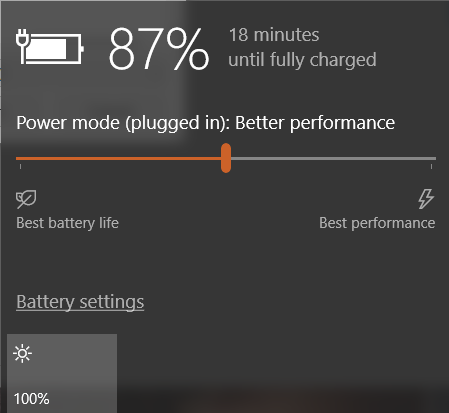

    There are a few things you need to get the slider:
    • The fall update; I have build 16299.64
    • Don't use a power manager (@wildbarry; you have the Dell Power Manager enabled which creates the problem for you)
    • You need to remove any custom (or previous windows) plan that you have, so the only mode left is 'Balanced (Recommended)

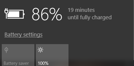

    If you do not comply with the above; your power option when you 'LEFT click' on the battery icon, looks like this:
    MISSING POWER PLAN - Can only create a 'Balanced' power plan aebe94ad-c663-4eee-bcca-6ed71adbbd74.png

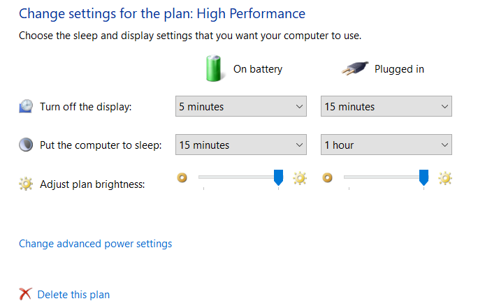

    2a. Fix your powerplan:
    If you have multiple powerplans, remove all but the 'Balanced (recommended)'. To delete a powerplan, make sure the 'Balanced (recommended)' is the default / selected one and open up the "Change Plan Settings" for the other plans. Then
    select 'Remove Plan'
    MISSING POWER PLAN - Can only create a 'Balanced' power plan a82b7b87-edb8-4513-bfae-955afd4b8865.png
    2b. If you already only have the 'Balanced (recommended)' plan, see if you have a power manager e.g. Dell or HP and uninstall it. Reboot and see if that fixed the issue.
    If not; and you only have the 'Balanced (recommended)',
    • Create a new power plan using the "Create a powerplan" option in 'Control Panel / Power Options'.
    • Create it. Reboot.
    • Check the 'LEFT click' on the battery icon'. It should not show the slider.
    • Remove the plan.
    • 'LEFT click' on the battery icon. (My experience is that it still shows the old L&F)
    • 'LEFT click' AGAIN on the battery icon! And now it should update the view with the slider.
    MISSING POWER PLAN - Can only create a 'Balanced' power plan b8eb59d3-f5cd-45e2-80df-5e644aa7eb54.png
    I hope that fixes it for most of you.
