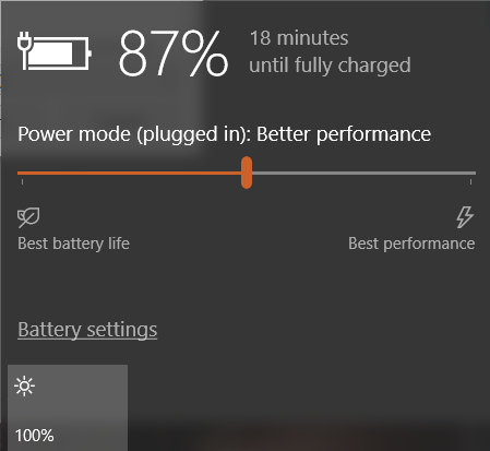

    There are a few things you need to get the slider:
    • The fall update; I have build 16299.64
    • Don't use a power manager (@wildbarry; you have the Dell Power Manager enabled which creates the problem for you)
    • You need to remove any custom (or previous windows) plan that you have, so the only mode left is 'Balanced (Recommended)

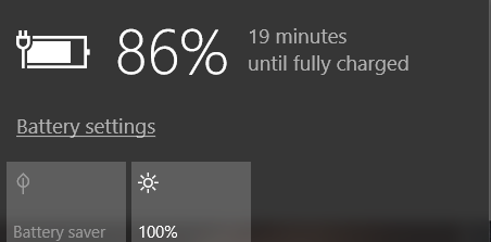

    If you do not comply with the above; your power option when you 'LEFT click' on the battery icon, looks like this:

    Fix:
    1. Upgrade to the latest windows version (duh)

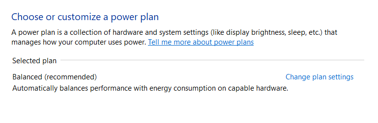

    2a. Fix your powerplan:

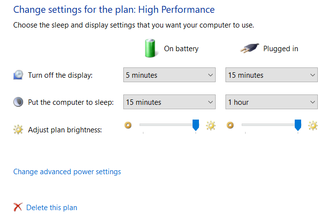

    If you have multiple powerplans, remove all but the 'Balanced (recommended)'. To delete a powerplan, make sure the 'Balanced (recommended)' is the default / selected one and open up the "Change Plan Settings" for the other plans. Then
    select 'Remove Plan'
    MISSING POWER PLAN - Can only create a 'Balanced' power plan a82b7b87-edb8-4513-bfae-955afd4b8865.png

    • 'LEFT click' on the battery icon. (My experience is that it still shows the old L&F)
    • 'LEFT click' AGAIN on the battery icon! And now it should update the view with the slider.
    MISSING POWER PLAN - Can only create a 'Balanced' power plan b8eb59d3-f5cd-45e2-80df-5e644aa7eb54.png
    I hope that fixes it for most of you.
