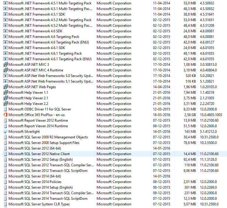

    On Windows 10, my MMC crashes when I try to add the certificate snap-in. When I click "Ok" after having added the snap-in (computer account, local computer) the message: "Microsoft Management Console has stopped working" and I am offered a debug option.
    There are no further error messages.
    I have tried to run "sfc /scannow" and found nothing to repair.
    My "programs and features" list looks like this:
    MMC faults and closes on adding Certificates snap-in 2b093b0b-eab2-4c94-931c-ce89fc5a424e.png
