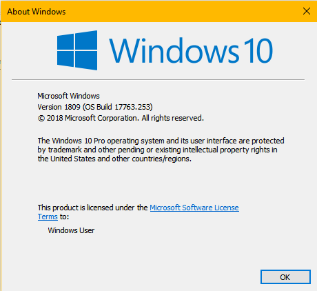

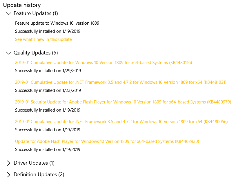

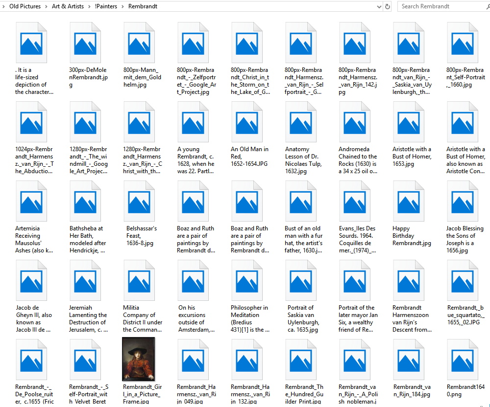

    Lately, when I go to look at an image in File Explorer or to insert an image in Word or Facebook, most of the images are not shown. I checked Task Manager and CPU, memory and disk are not much busy. After a full 15 minutes, File Explorer still has not shown almost all the images as shown below:

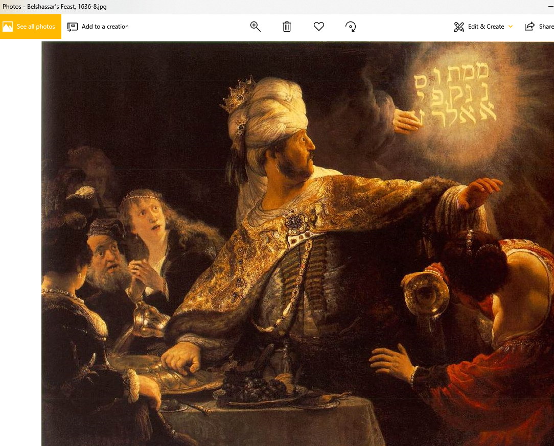

    I double-clicked on several of these jpegs and they pop right up in Photos:

    Regarding which files do not have thumbnails: .jpg, .bmp, .avi, .mp4, etc.
    They have different icon designs, but no thumbnails.

    • Changing the default photo viewing program from Photos to Paint changes the design of the icons displayed in File Explorer, but does not result in the thumbnails being displayed.
    • Opening a .jpg file in Paint and saving it as a .bmp does result in the thumbnail displaying in File Explorer.
    • Interestingly enough, opening a .jpg file in Paint and resaving it as the same .jpg file also results in the thumbnail displaying.
    • Even more interesting is that opening a .jpg file in Photos and selecting Edit & Create, Edit, then Save a copy, results in the thumbnail subsequently displaying in File Explorer WHETHER OR NOT the file is actually saved (the final step in saving a copy).
    I guess the bottom line is that there appears to be an issue between the files as saved on my PC and File Explorer which may not be influenced by either Photos and/or Paint.
    Note these exact same files backed-up/duplicated on my Laptop (purchased only a couple months after the PC) properly display as thumbnails in File Explorer.
    Certainly, I could spend an indeterminate amount of time going through hundreds of photos, opening each one and resaving them, but that clearly seems inappropriate…there has to be a better way.
