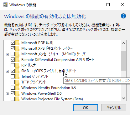

  2. yuispg Win User
    Where is client for NFS in Windows features setting?
    I refer this web page for mounting Ubuntu 16.04 OS on my Windows 10 HOME.
    So... I look for "client for NFS" in accordance with the page. But I cannot found it as below image.
    I'm sorry for not English but you know there is no the word "NFS".
    How do I enable "client for NFS"? Or is it impossible?
    mount nfs share with nfs client dfdb9979-067e-4d95-b75c-2bce5878775c?upload=true.png
    yuispg, Jun 13, 2019
