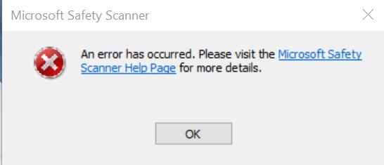

    Hello all! I have an HP Omen desktop with Win10 Home and my OS Build is 19045.2673. There appears to be a problem with the latest builds of Microsoft Safety Scanner (MSERT) 64 and 32 bit. I have downloaded this several times today and each time I try to open it I get this error below. I have ran SFC, DISM with no corrupt files found. Thinking I may have malware I ran Malwarbytes and Norton 360 scans and all are clean. I ran update troubleshooter and it was fine. My Event viewer had no errors.
    MSERT Scanner Found - regkeyvalue://hklm\software\microsoft\windows... qMRcTLQg%2fpR9p9ytJQcHL4HW3VvMwWoTnuPRqE1%2fP3R8OPuPFWBoYbTIR%2fzEuiueQz1%2fB44s4IHRNwcnOCA7s%3d.jpg
    I went to
    https://support.microsoft.com/en-us...-scanner-6cd5faa1-f7b4-afd2-85c7-9bed02860f1c as suggested but was not much help except that I did open the Run Box as suggested and entered %systemroot%\debug which took me to windows >>Debug. I selected MSERT from the debug log and opened it to notepad and scrolled down to the last entry. There I found the below entry which was causing MSERT not to open.
    MSERT Scanner Found - regkeyvalue://hklm\software\microsoft\windows... Qs8Uqm6wm%2fJKvtkaL04FOapayi3q4WquDKfJkyPBxvFc7mc8eG3f5tI8wCB7wx7KG%2bHWHggbJHV0dEZ1o23bKuz2U%3d.jpg

    Reddit - Dive into anything concerning the same thing. It was good to know that I was not the only one experiencing this and my machine was fine. I would like to point out as well that I still had an MSERT in my download folder I had installed on 3/1/23 and this opened fine and ran perfectly with nothing found. It seems clear the MS is putting out bad builds of MSERT for some computers and it needs to be fixed as it is useless the way it is now for me and other users.

    Thank you for your reply and the links. I just got done submitting a bug report via the FeedBack Hub. This is clearly a MS problem. Thanks again for your reply..
