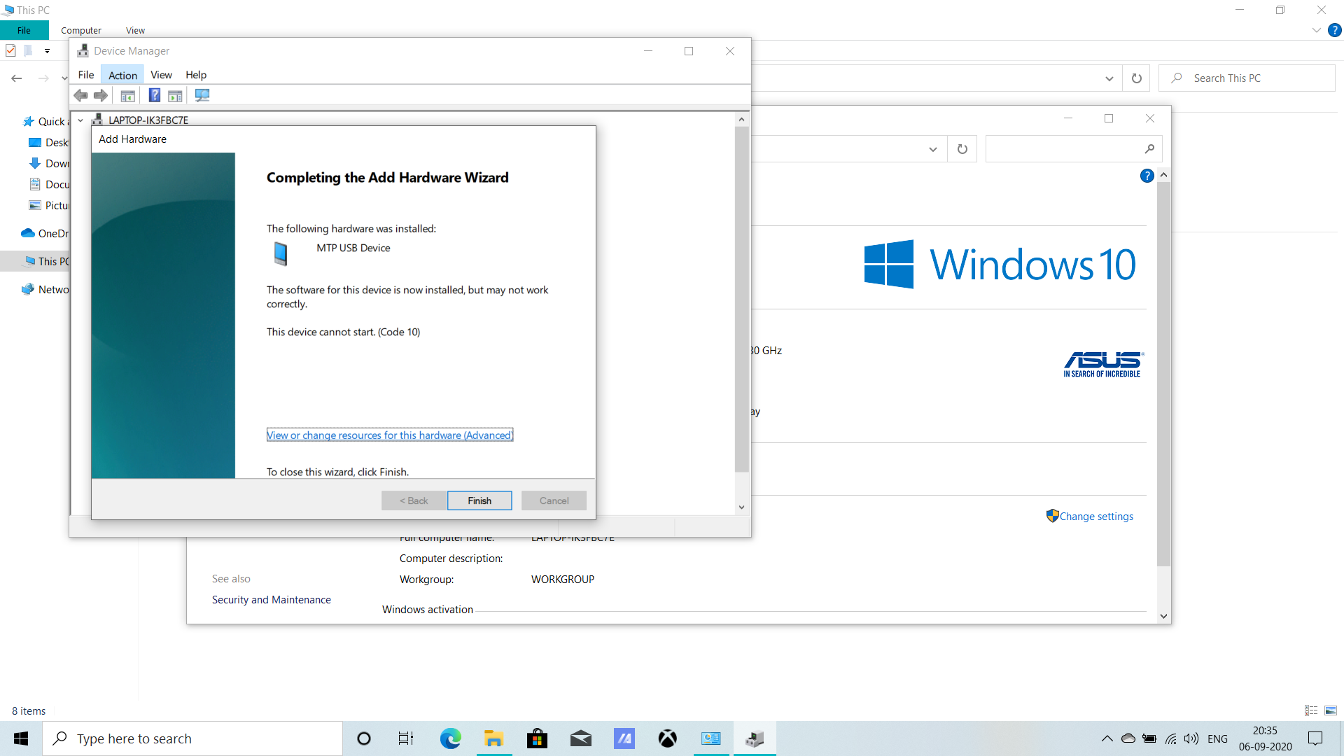

  1. MTP driver cannot start code 10
    pc not responding on connecting mobile phones , other usb devices such as flash drives and input devices are working properly.
    the phone is charging when connected but nothing else happens.
    see the img file below to see the response of driver .
    please help
    thanks...
    MTP driver cannot start code 10 a6d07540-d5a9-43ad-aaf6-8484b2a43f4d?upload=true.png
    Vaibhav Srijan, Sep 6, 2020

  3. Ch863 Win User
    MTP Driver Error when trying to update or reinstall (Windows 10)
    I had the same issue with Windows 10 1607, Windows correctly installed the MTP driver for my phone the first time I plugged it in, then failed to recognize the phone the next times I plugged it in using the MTP protocol. Seems it's a bug with Windows 10,
    if you google "Windows 10" MTP android limiting the search to the past month you'll find a bunch of people with the same issue.
    Try to manually install the MTP USB Device driver see if that fixes the issue for you too.
    Right click on your phone (should be in Portable Devices) in the Device manager, on the driver tab click "Update Driver..." On the "update Driver Software" window select "Browse my computer for driver software" on the next windows select "Let me pick from
    a list of device drivers on my computer" then in the list of compatible hardware devices, select "MTP USB Device" click next and your phone should be working again.
    If you don't see MTP USB device in the list of compatible hardware, manually install the MTP USB device using the Add legacy hardware wizard. (Add legacy hardware -> Install the hardware that I manually select from the list (Advanced) -> in the list select
    "Portable Device" -> in the next list pick "MTP USB Device" then install it. Once it's installed redo the steps I gave you in the previous paragraph, the "MTP USB Device" should be showing now in the list of compatible hardware.
    Cheers~
    Ch863, Sep 6, 2020
  4. MTP driver cannot start code 10
    Ch863 thnak you very much this saved my life, after spending like week searching with no luck,
    kigenzaaime patrick, Sep 6, 2020
