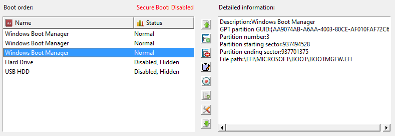

    OK so here is the conundrum I am currently facing. I'll list my steps and where I am.
    First, I wanted to install gears 5 but couldn't because for some reason my computer wasn't updating (had no idea this was going on) and I didn't meet minimum requirements. So I attempted to download a windows 10 updating tool which told me I couldn't because I had a mbr system and not a gpt.
    So I converted my system to gpt with some Microsoft tool and that worked just fine until I rebooted. After my reboot it says I didn't contain an efi boot file so the system couldn't start. I followed a couple guides and was able to boot into a recovery USB drive and through CMD generated a new EFI system partition. That gave me a second windows boot manager, and after I successfully updated my computer it gave me a third. Now I have multiple windows boot managers all on one hard drive but only the bottom one is real; the others just blue-screen-of-death (see image below).
    Multiple false windows boot managers [​IMG]
    I'd like to remove these duplicate windows boot manager so I don't have to spam F11 every time the computer starts up as the correct option is not default.
    I installed a trial version of EasyUEFI and it at least shows me that three windows boot managers exit but heck if I know which is the correct one or what to do about it.
    Multiple false windows boot managers 4886adbd-d49f-4abf-a4c5-87e1e7984afa?upload=true.png

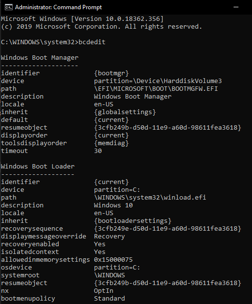

    -yes I've run bcdedit and it only listed the following:
    Multiple false windows boot managers 18d4bbf5-8d34-4fe9-9f3b-2f7f169407f0?upload=true.png
    So i'm a little stuck. I'm not sure what I should do next and reinstalling windows is not an option because I can get into windows with quick F11 fingers.
