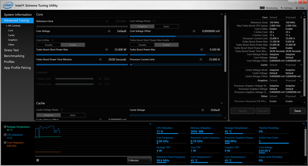

  4. My CPU is capped at a low percentage of usage and CPU frequency after recent Windows Update
    CPU usage capped & frequency locked to 0.59 GHz
    I've been running into a problem with my HP Spectre 13 X2 where after a few sleep/wake cycles the CPU usage caps at 33% and the frequency locks to 600MHz. It stays this way until a reboot - hibernate/resume won't resolve it, nor will plugging in/removing
    AC power.
    I saw a report of a similar sounding issue where someone was able to work around this problem by removing the Microsoft ACPI-Compliant Control Method Battery device from device manager & letting windows reinstall. That hasn't helped for me. A hard reboot
    is the only workaround I've found.
    Wondering if there was any power/thermal throttling going on I installed Intel Extreme Tuning Utility to diagnose -- no power/thermal throttling is going on. Screenshot attached. So I think windows just isn't trying to run any faster.
    Any thoughts/suggestions are appreciated..
    - Joe
    My CPU is capped at a low percentage of usage and CPU frequency after recent Windows Update 5d07ccbd-0b3e-4717-a3cf-53e72bc32342.png
    JoeDoucette, Apr 17, 2020
