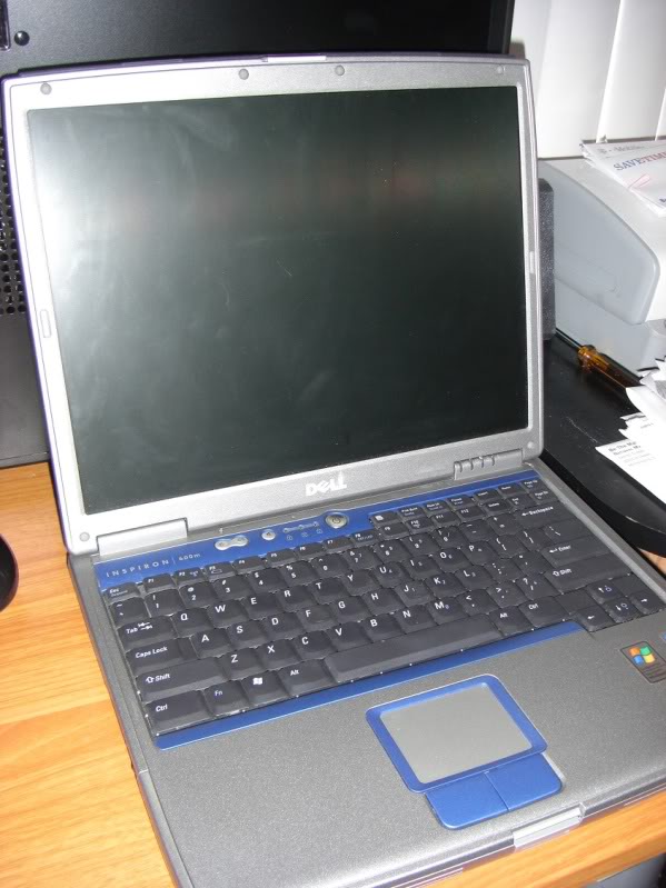

  4. My dell laptop is not recognize the charger and won't charge
    Battery Charger for a Dell Laptop
    My friend just gave me a Dell Inspiron 600M Laptop which did work last time he used it, but that was a couple years ago. He no longer has the battery charger for it and I know I can easily buy another one for it. I have two questions: Could there be any long-term effects to the battery for not being charged for over a year or 2? ....and (this is a long shot) would the battery charger from my old Gateway Laptop work on this Dell 600M?
    t77snapshot, Jan 10, 2019
