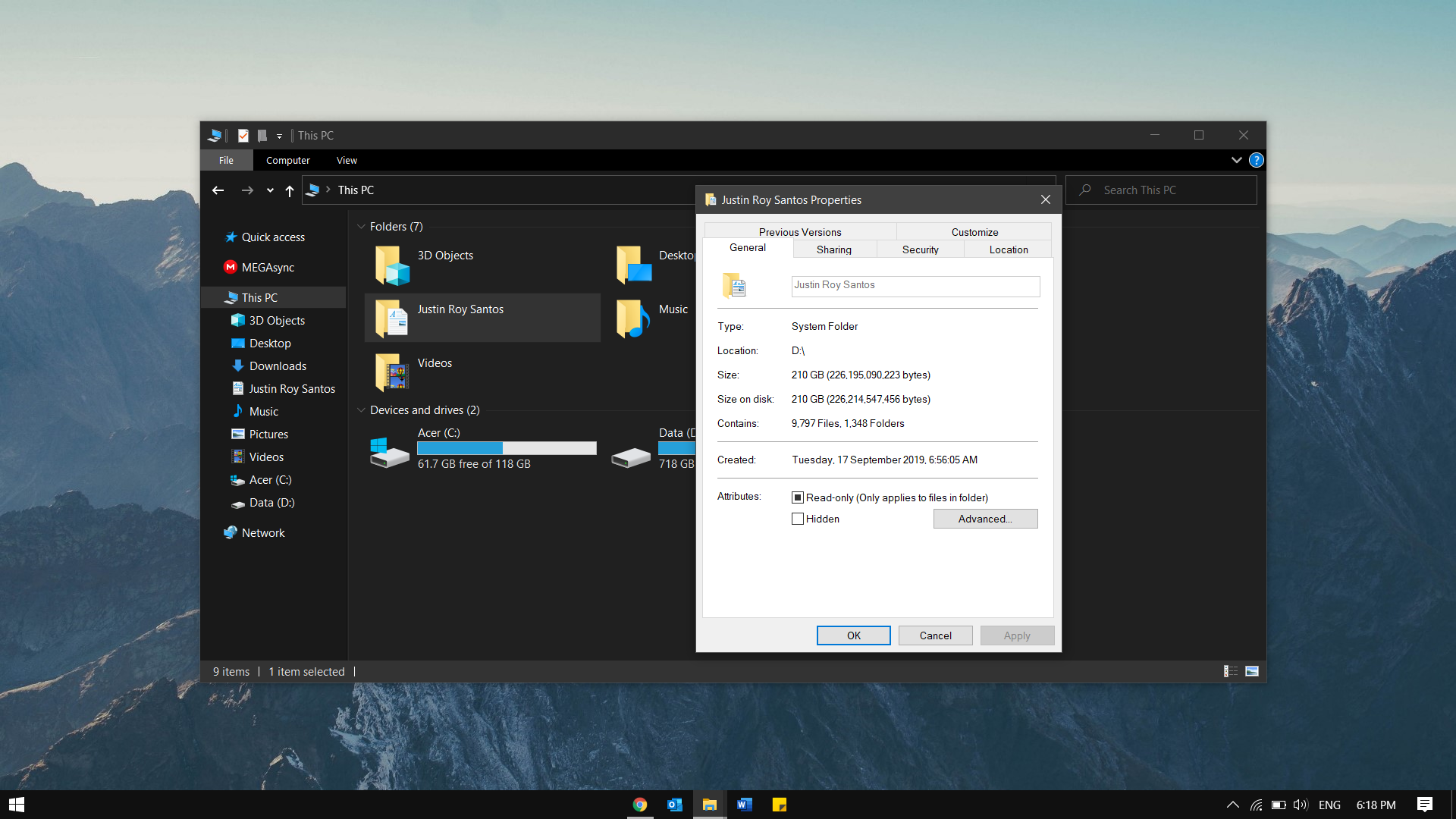

Discus and support My documents folder under This PC became my user folder! in Windows 10 Network and Sharing to solve the problem; This is how my documents folder under this PC looks like now:[ATTACH] This happened after I tried to move my documents folder out the OneDrive folder... Discussion in 'Windows 10 Network and Sharing' started by GetRektNoobs, Aug 18, 2020.
  1. My documents folder under This PC became my user folder!
    This is how my documents folder under this PC looks like now: My documents folder under This PC became my user folder! fa0df59b-536b-488e-8e27-7ea30dddebfc?upload=true.png
    This happened after I tried to move my documents folder out the OneDrive folder and into the user folder through the location tab inside the properties of the folder. However, I failed to move it because the computer does not let me so the real documents folder is still inside the onedrive folder. After I did that, my user folder inside D: was renamed as documents with a matching icon. I renamed that folder back to my name and the same with the icon. Then I noticed something wrong shown in the picture shown above. How do I fix this? Thank you so much. Please help me

    Hi Chris,
    I suggest you to Restore to Default the folders and document settings and see if it helps.
    Step 1:
    Please follow below steps and check if it helps.
    • Go to Download folder.
    • Right click on the Download Folder and go to Properties.
    • In Properties go to Location tab.
    • In location Tab Click on Restore Default.
    Step 2:
    • Go to Documents folder.
    • Right click on the Document folder and go to Properties.
    After performing above steps change the settings as you required and check if it helps.
    Hope these information helps, please get back to us for future support, we’ll be glad to assist you further.
    Prabhavathi Patil, Aug 18, 2020

    Multiple 'Documents' folders under 'This PC'
    This may happen if one the “documents” folder has been stored on different target location.
    Follow the methods below and check if it helps:
    Method 1
    I suggest that you check both the folders location where they are saved using the below method:
    • Right-click on any one documents folder and then click Properties.
    • Click the Location tab, click Restore Default, and then click Apply and OK.
    • Check what happens, try these step on all the documents folder.
    Method 2
    If the above step fails then try checking the target location of both the folders by using the find target option:
    • Click the Location tab, click Find target.
    • Check where the target location of both the folders is and check if any one goes to the user name location and later delete the one which goes to wrong location.
