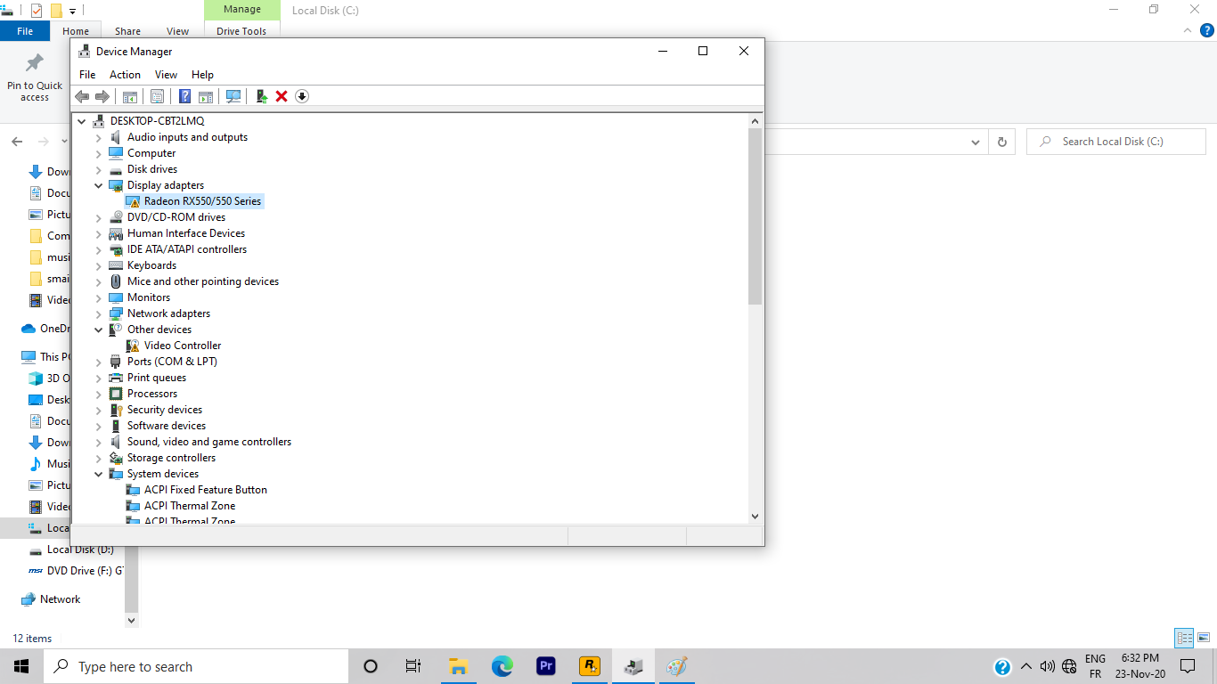

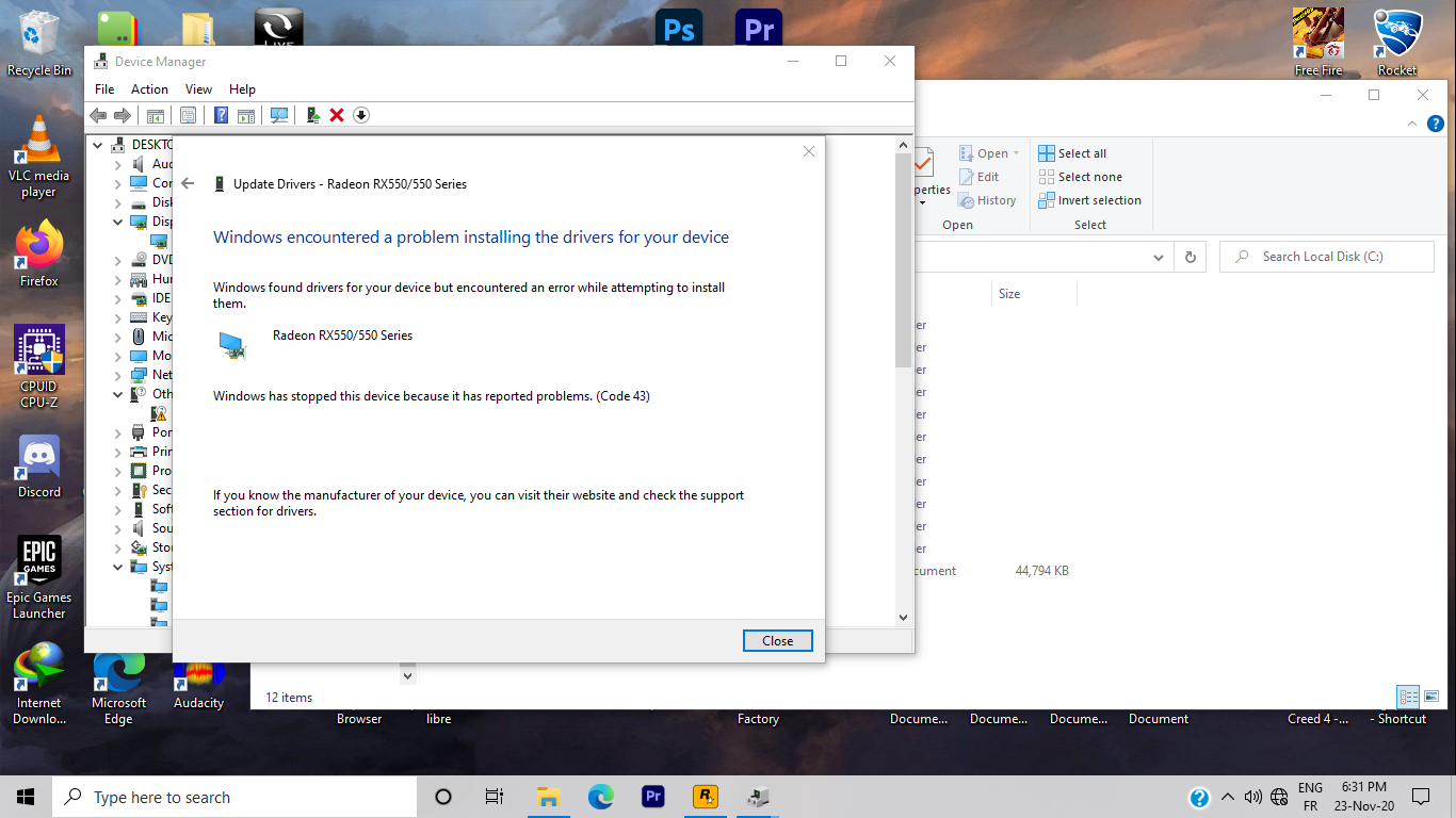

    Hello Microsoft community,
    today i received my brand new graphics card msi rx 550 2gb lp and i installed it in the motherboard and i downloaded the latest driver version and it wont work, i uninstalled it and reinstalled the previous version but nothing happened, i have latest update for my windows
    could you please help i'm fighting with this issue over 6 hours my graphics card driver wont install *error code 43* 95a1a7db-b389-498a-9188-64a9572959e7?upload=true.png my graphics card driver wont install *error code 43* e1036b98-0197-48cf-af58-95e2dcec3098?upload=true.png

  4. Nikhar_K Win User
    Error code 43 for NVidia graphics driver
    I appreciate the efforts taken by you in resolving the issue. I understand that you receive an error code 43 for the NVidia Graphics Driver in Device Manager. I’ll certainly assist you with the issue.
    Ideally, the recommended resolution for the error code 43 is to reinstall the Graphics driver, as you have already tried reinstalling the drivers, let us try doing a clean installation of Graphics driver and see if that helps.
    Refer the steps mentioned below:
    1. Press Windows key + R. This will open
      Run. Alternatively, you can go to Start and search for ‘Run’
    2. In Run dialog box, type ‘devmgmt.msc’ and hit
      Enter.
    3. Expand Display adapters.
    4. Right click on the NVidia driver and click on
      Uninstall.
    5. Now check the box Delete the driver software for this device.
    6. Click on Uninstall
    7. Do not restart the PC
    Download the latest drivers for the graphics card from NVidia
    website
    , once you download the drivers perform a clean install of drivers by following the steps mentioned below
    1. Navigate to the location where the driver is downloaded (Usually it should be in the
      Downloads folder).
    2. Double-click on the driver to
      run it.
    3. Click on OK to start extracting the driver packages.
    4. Accept the License agreement and proceed further.
    5. Under Install options select
      Custom (Advanced)
      and click on Next
    6. Check the box next to
      Perform clean install and click on Next
    7. Follow the onscreen instructions
    Let us know the results, we will be glad to help you further.
