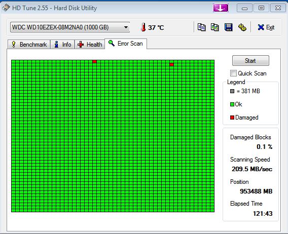

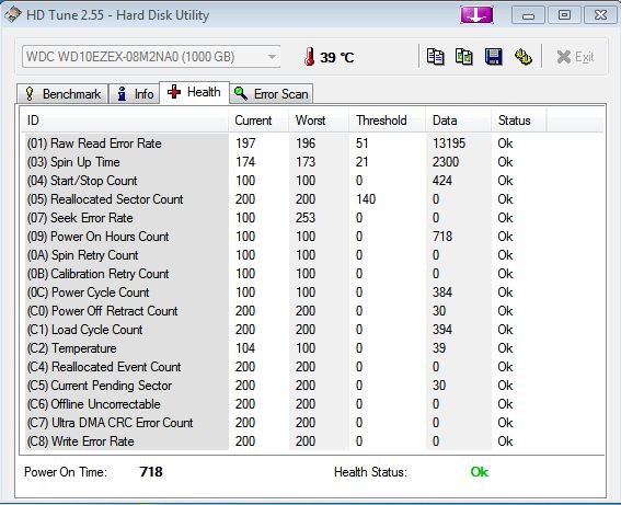

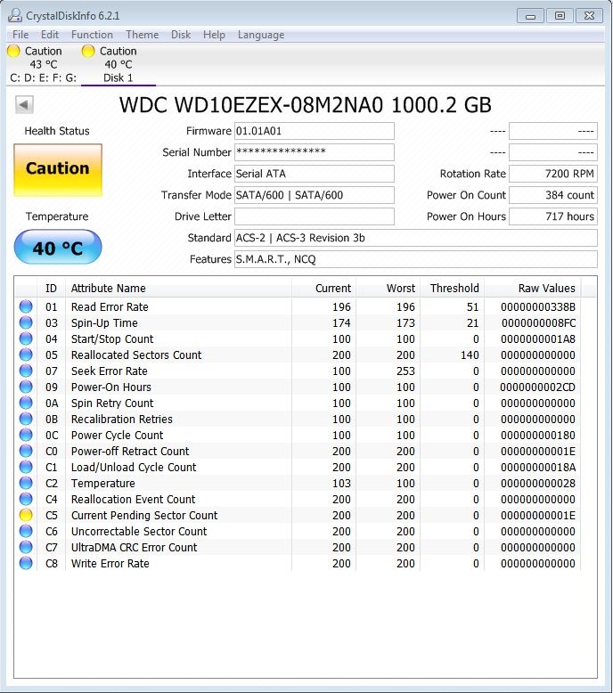

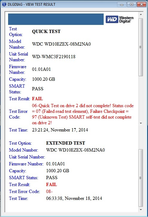

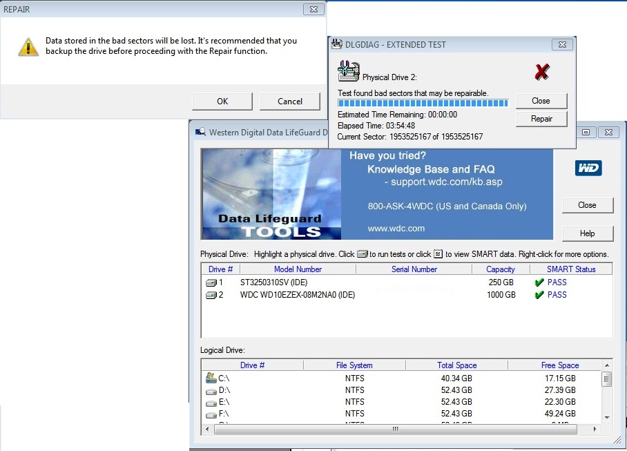

  4. my HD Disk Health at 52%
    HDD Health Report: Crystal Disk Info, HD Tune, WD-Data Lifeguard Diagnostics.. pls help
    WD TB Blue - 5 months old.
    Following are the HDD Health Report: Crystal Disk Info, HD Tune, WesternDigital - Data Lifeguard Diagnostics
    Pls suggest.
    Issue: Win7 sometimes started working slow, and then it gets stuct up in safe mode at "CLASSNPN.SYS".
    Tried installing fresh Win7.. worked fine for sometime but then started with the same issue.
    SO i did the health check.
    Crystal Disk Info:
    HD Tune :
    alivehunter, Dec 22, 2020
