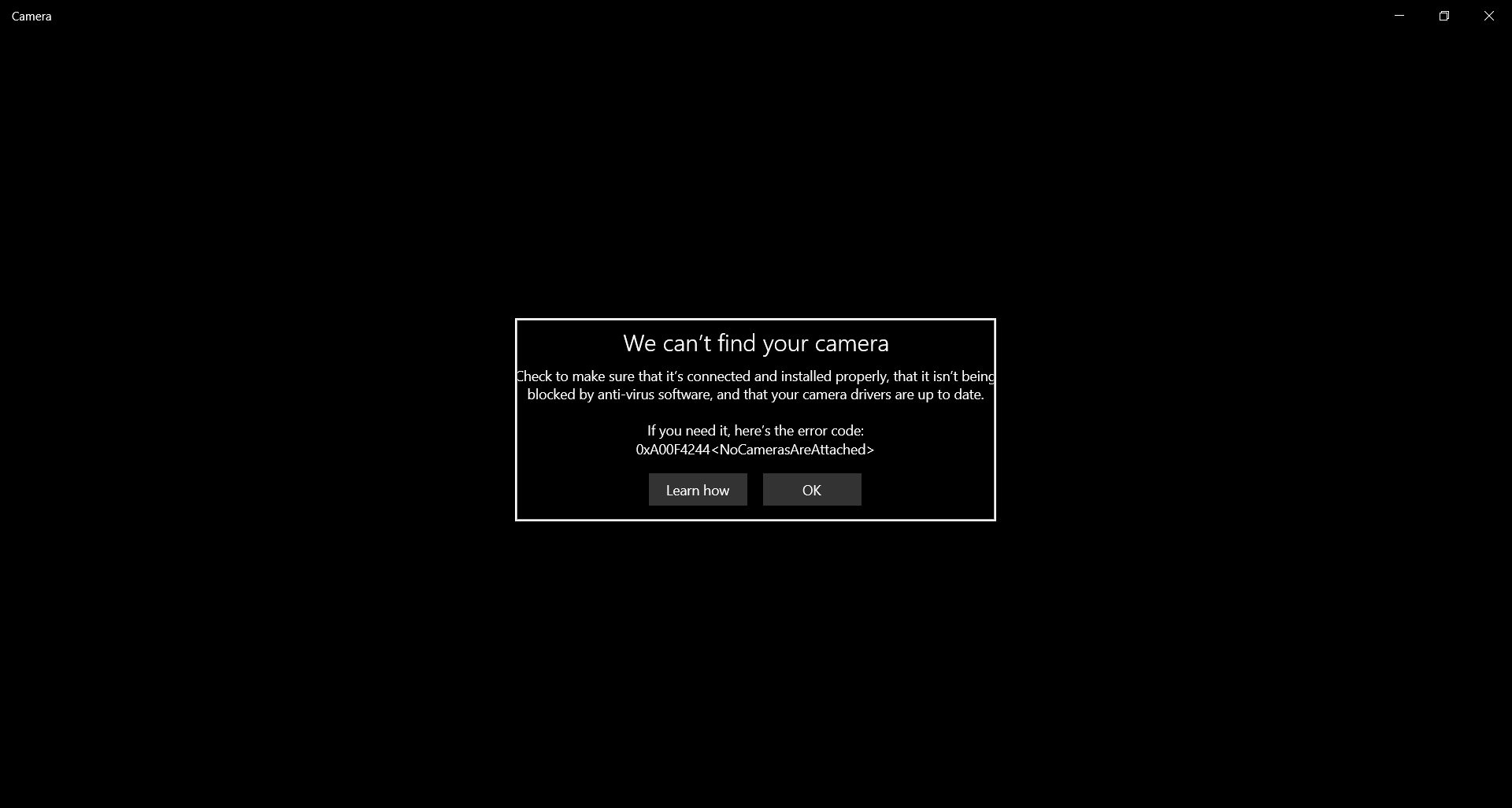

  1. My laptop's webcam is not working.
    When I open the camera app it says that we can't find your camera. in other apps Zoom meetings it also shows the same message
    My laptop's webcam is not working. 3cb3b4aa-9b1f-4843-806a-a73a26dae343?upload=true.png
    sujay_isarani, Aug 25, 2020

  4. Naresh_K Win User
    Webcam not working
    This issue can occur if the camera drivers are not up-to date, your anti-virus may be blocking the camera, or camera app is not installed properly. I would suggest you to follow the troubleshooting steps mentioned in the article:
    Camera does not work in Windows 10. You can also refer to the suggestion on HP article:
    HP PCs - Webcam Troubleshooting (Windows 10, 8).
    If you need any further assistance, please write back with the following information:
    1. What happens when you are trying to access Camera app?
    2. What is the exact error message you are getting?
    3. What is version of Windows 10 that is installed on your device?
    4. Are you using an external webcam? If yes, please help us with the make and model of the webcam.
    Naresh_K, Aug 26, 2020
