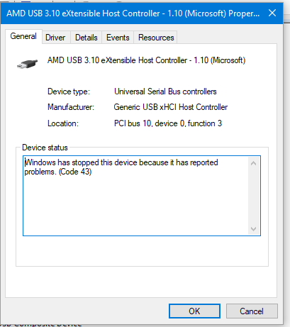

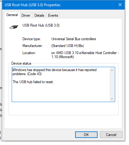

    My USB backports somehow are not working anymore while I was typing. My keyboard, and my mouse are attached to the backports. It won't detect any usb devices I plug in. I have 6 USB backports, 4 USB 3.0 and 2 USB 2.0, but the one that are not working is the USB 3.0 Ports. In the Device Manager My USB Root Hub 3.0 status said like this:
    My USB Back ports stops working, USB Root Hub has failed to reset 83384b47-7943-453d-b28a-937c3cc5a0c5?upload=true.png
    I tried uninstalling it, rebooting my computer, updating the driver but if I update the USB Root Hub, another USB will have the problem and it's the AMD USB 3.10 eXtensible Host Controller - 1.1.0Microsoft
    My USB Back ports stops working, USB Root Hub has failed to reset 0e802bae-c3ed-40d0-9bcc-3c366f22e684?upload=true.png
    Also if I look at the events tab, the driver for AMD USB 3.10 is usbxhci.inf and the driver for USB Root Hub is usbhub3.inf

    And if I click one of the events in the USB root hub events tab, in the Information page, it will come up as below
    Device USB\ROOT_HUB30\5&5477969&4&0 was configured.
    Driver Name: usbhub3.inf
    Class Guid: {36fc9e60-c465-11cf-8056-444553540000}
    Driver Date: 03/18/2019
    Driver Version: 10.0.18362.1
    Driver Provider: Microsoft
    Driver Section: Generic.Install.NT
    Driver Rank: 0x800002
    Matching Device Id: USB\ROOT_HUB30
    Outranked Drivers:
    Device Updated: false
    Parent Device: PCI\VEN_1022&DEV_149C&SUBSYS_79141849&REV_00\4&1fde7688&0&0341
    and I've tried scouring the internet for solution but I can't seem to find one. Also here are my Specs:
    AMD Ryzen 5 3600
    Asrock AB350-HDV Motherboard
    AMD Rx 570
    Klevv 16GB of RAM
    And also Here's what I have tried doing to solve this problem but didn't work
    1 Uninstall the device from Device Manager
    2 Install my chipset drivers
    3 Update the USB Drivers
    4 Reset My Windows 10
    5 Turn off USB Selective Suspend Setting for each power plan
    6 Turn off the device in the power management tab.
