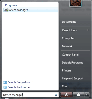

    To open device manager for Windows Vista or Windows 7:
    Mobile Legend
    1. Click on Start, and on the search bar type in Device Manager.
    2. Press Enter.

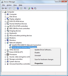

    3. In device manager click on the + or triangle for network adapters.

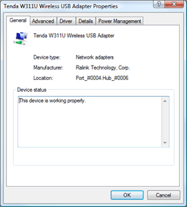

    4. Right click on the wireless adapter (name will vary), and select properties.

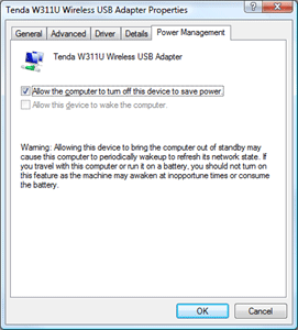

    5. In the properties window for the wireless card, click on Power Management tab.
    6. Remove the check mark for Allow the computer to turn off this device to save power.
    7. Click on OK, and restart the computer.

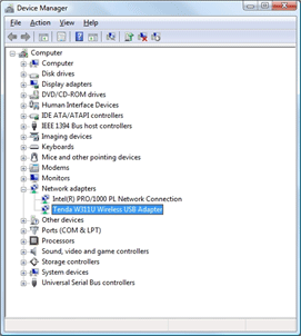

    8. The wireless USB adapter will no longer power down or have trouble staying connected to the network.
