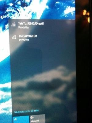

    If I click on Wifi icon it shows only ONE (max two) NETWORK:
    My Wifi and bluetooth stops working and I have to network reset to make it work again every... 62047d1485962659t-wifi-stop-working-win10-shows-only-one-network-doesnt-connect-medium.jpg

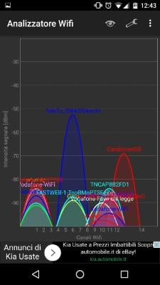

    And I live in a building with 20+ networks, as you can see from WiFi Analyzer (I'm the red one on the right)

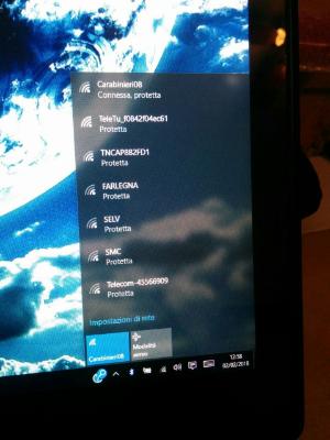

    If I deactive/reactive Wifi with fn+f12, it goes to Airplane mode and to Wifi mode again and it eventually shows all the networks:
    My Wifi and bluetooth stops working and I have to network reset to make it work again every... 62049d1485962659t-wifi-stop-working-win10-shows-only-one-network-doesnt-connect-medium-1-.jpg
    My Wifi is on the top. If it's saved, Windows connects to it and then it drops the connection; if it's not saved and I try to connect, it says "You're not able to connect to this network".
    The fun fact is that after some seconds every network disappear and only one is showed (probably the neighbour one..I dunno).
