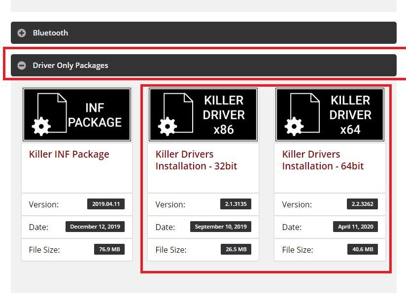

  3. Killer Wi-Fi 6 AX1650
    Hello Karzan,
    My Name is Paul one of the Community Advisor and a Microsoft Consumer like you, I do understand that you are trying to install your WIFI Driver which is Killer WIfi-6. I suggest instead of downloading it form the Control Center kindly download the Driver Only Package Instead. I also experienced this problem since I am using a Gigabyte Motherboard with Killer Lan/WIFI.
    Source File:
    https://support.killernetworking.com/software/
    I will attach a screenshot for reference.
    My wifi driver has a killer problem. 1006e4d1-3352-4938-9d2f-840dde83e5e3?upload=true.jpg
    Paul_Mykel, Aug 16, 2022
