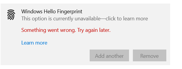

  1. my windows hello fingerprint sign in doesn't work
    my windows hello fingerprint sign in doesn't work when i try to sign in. when i look at it in settings it just says this option is currently unavailable, please try again latter, or something went wrong please try again latter. I also can't click add another f my windows hello fingerprint sign in doesn't work 35351eb6-40b2-4bb8-a618-328372d3a63e?upload=true.png ingerprint or remove. how do i fix it?

  4. my windows hello fingerprint sign in doesn't work
    Windows Hello Fingerprint issue
    Hi Nikhar,
    Thanks for the reply.
    Yesterday I had a chat discussion with one of the Microsoft tech agents. After much troubleshooting and hit and try, some issues got fixed.
    I use HP Client Security for fingerprint login. There I also created 'spare key' which was preventing Windows to show fingerprint login option. When I removed spare key option, I got back the fingerprint login option for me.
    Thanks & regards,
    Rajesh Pathak
    RajeshfromIndia, Feb 28, 2020
