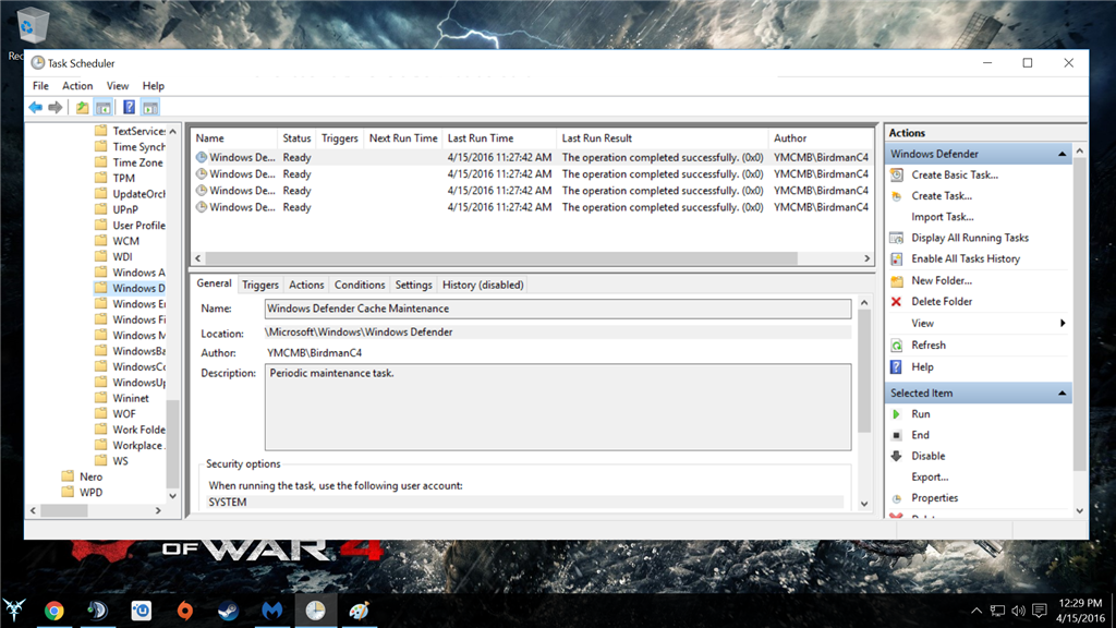

    Hi everyone. Im having a problem with windows defender task schedule. I have set triggers for the 4 processes under windows defender in task schedule, and then I deleted the triggers. What I noticed the next day is: windows defender performed a scheduled
    scan twice. The first time at 8:30 AM. When I checked task schedule after the first scan only the scheduled scan was completed. The other 3 processes which includes (windows defender cache maintenance, windows defender cleanup and windows defender verification)
    did not start as yet. Then after about 2 hours I checked windows defender and it says: last scan: Today at 11:30 AM. I was confused because it already performed a scan today. So I went and checked task schedule and saw that all 4 processes were completed at
    11:30 AM. So why did It perform the first scan any way? Do you think the trigger I created and then deleted corrupted some of the files there? Or is this behavior normal? Also before I created the triggers for all 4 processes I saw that there were no authors
    listed for them. Since I created the triggers I noticed my username and CPU name would show up under author for each process. Now that I deleted all 4 triggers I still see my username and CPU name listed for each process. Is this normal?
    Need Default Triggers for Schedule Scan Task 89d71a04-a7dc-4124-b3be-ff4ba3134bf0.png
    BirdmanC4, Oct 4, 2019

  4. Need Default Triggers for Schedule Scan Task
    Task Scheduler-Windows Defender Scheduled Scan fails (quick scan)
    It looks like you’ve added triggers to all of the Windows Defender scheduled tasks. All of these tasks are actually
    system tasks and they’re all being triggered automatically every day by
    Windows Automatic Maintenance – so it’s pointless to add another trigger to any of them (despite the fact that Microsoft published a bogus method for scheduling a scan by adding
    a trigger to the Windows Defender Scheduled Scan task):
    Windows 10, How do I set Windows Defender's scan schedule?
    There are multiple issues with scheduling a scan by adding a trigger to the
    Windows Defender Scheduled Scan task in the new release of Windows 10 (Version 1607), as I've explained in this thread:
    Windows Defender
    Additionally, you might have an issue with the file path for the
    Windows Defender Scheduled Scan task that needs to be corrected. My recommendation would be to delete all of the triggers that you’ve added to the Windows Defender scheduled tasks, and then set up a daily Quick Scan with
    the proper method for scheduling any task in any version of Windows – the
    Create Basic Task Wizard. In order to avoid the new
    erratic scan issue that cropped up in Version 1607, you’ll also need to be sure that you
    don’t change the user account when you get to step 7 here – just leave the account for your task at the default setting:
    How do I set Windows Defender to a custom auto scan
    GreginMich, Oct 4, 2019
