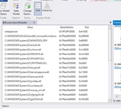

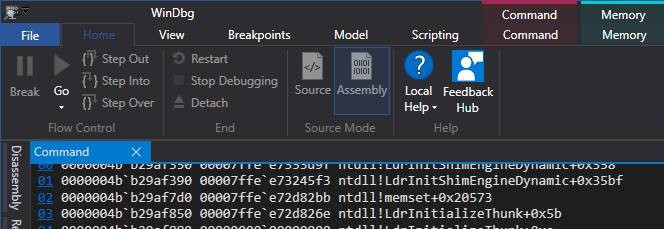

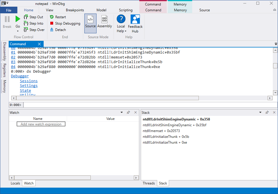

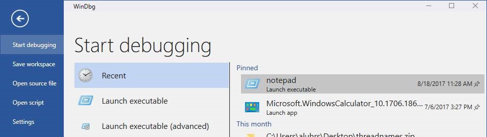

    New WinDbg available in preview for Windows 10
    Source: New WinDbg available in preview! Debugging Tools for Windows
