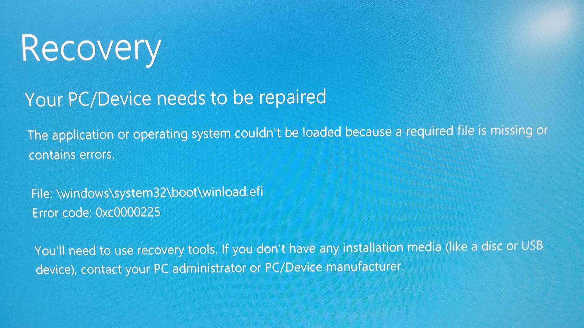

    Problem 1: System Repair Disc Issue
    1 After upgrading from Windows 10 version 1903 to 1909, I created a new Bootable DVD with the System Repair Disc. When that was done in early-November, the Windows 10 OS Build was 18363.476
    2 After the regular monthly Windows Updates sometime in mid-December, my OS build was “updated” to the current 18363.535.
    3 Yesterday, I made a new System Image of Drive C, and decided to create another copy of the System Repair Disc again as bootable DVD. Upon the successful creation, I decided to make sure it boots. Well, it did not as I got this error:
    Need help with Windows 10 System Image Backup / Recovery / Repair 27905a7d-d29d-4052-922e-c16ad8673661?upload=true.jpg
    4 I tried to create two other bootable System Repair Disc’s, and I got the same error.
    5 I took out the DVD that I created in mid-November, and it booted just fine and it took me to the Windows 10 Recovery menu without any problems.
    6 I then cloned made a DVD copy of thw November-made DVD, and tried running the copy I made. It worked perfectly and again got me to the Windows 10 Recovery menu.
    What is happening? Why am I getting the WINLOAD.EFI error when I am trying to boot into Windows 10 Recovery mode DVD with OS build 18363.535 but no problems with older OS build 18363.476?

    Your question does not contain all the required information needed for us to help you. I suggest you to provide more details regarding the issue you’re facing.
    Please provide us more information help you better:
    • What is the exact issue that you are facing?
    • Did you receive any error message or error code?
    • What is the error that you receive while performing system image recovery through repair disk?
    • What all troubleshooting steps have you done?
    Reply with necessary information to help you better.
    Anju Thekkethil, Dec 29, 2019
