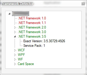

    I'm having a strange problem with .net framework applications. Basically any app that requires .Net framework 3.5 gives me this error:
    Could not load file or assembly 'UIAutomationProvider, Version=3.0.0.0, Culture=neutral, PublicKeyToken=31bf3856ad364e35'
    I believe it has something to do with the way the .net framework is built into Windows 7, but not sure how to solve it. When I go to program features and uncheck/check .net framework to reinstall, I just get an error.
    The odd part is, when I run this tool for checking .net framework:
    CodePlex Archive
    I get results that look like I should be having no issues:
    NET Framework 3.5 and 4.7.2 for Windows 10 version 1809 for x64 Issue WviYm.jpg
    Has anyone ever had this kind of problem?
