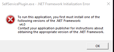

    When I try to open any application which used .NET framework I get the following message:

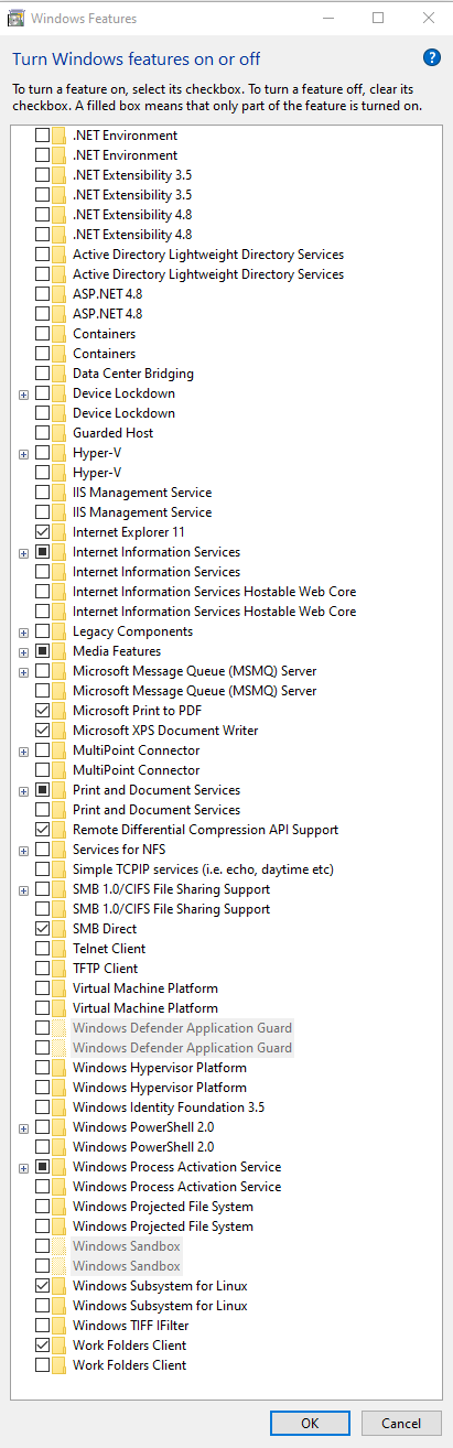

    Looking in the 'Windows Features' window there seems to be a duplicate of many of the items, and no options for .NET Framework 3.5 or 4. If I try to tick the box next to any of the .NET Extensibility items it will be unticked the next time I open the window.

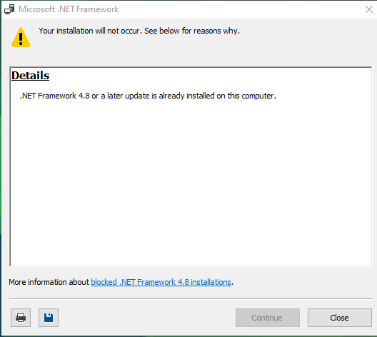

    And if I then try to install the .NET framework from the microsoft offline or web installer I get the message that .Net Framework 4.8 or later is already installed

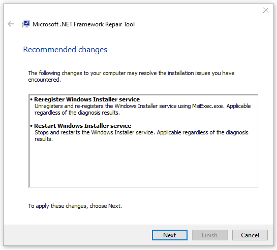

    I've tried running the .NET Framework repair tool, which came back with the following actions, however that hasn't solved the problem.
    .Net Framework missing from Windows Features 7c9c4737-3392-499f-91cb-3cef4b985db8?upload=true.png
    The next step gives a lsit of logs, which I'm happy to attach if any of them may be relavent.

    I suggest you to un-check and recheck .Net framework 3.5 and .Net framework 4.6 advance series from Windows features.
    Try the following steps:
    • Press Windows + R keys to open Run command.
    • Type Appwiz.cpl and select "turn Windows feature on or off" from the left
    • Uncheck .Net framework 3.5 and .Net framework 4.6 advance series.
    • Restart the computer
    • Repeat step 1 and 2 and check .Net framework 3.5 and .Net framework 4.6 advance series.
    • Restart the computer.
