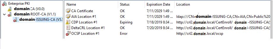

  3. debbasu Win User
    OCSP Verification failed with error code
    Hi All,
    Can you please help us with following error while configuring OCSP while validating through below command. CDP and AIA is working but OCSP validation have issue. Though OCSP configuration showing no error.
    certutil -verify -urlfetch C:\Users\user\Desktop\test.cer
    ---------------- Certificate OCSP ----------------
    Failed "OCSP" Time: 0
    Error retrieving URL: Method not allowed (405). 0x80190195 (-2145844843 HTTP_E_STATUS_BAD_METHOD)
    http://crl2.domain.local/ocsp
    Also PKI view shows below error:
    .NET support for OCSP Stapling fb02783f-36ad-41e8-a829-79476ca13f18?upload=true.jpg
    Please find the environment details as follows.
    Currently we have two enterprise PKI env.
    Old Env: Single Server served as Root CA and Issuing CA
    New Env: Two layer architecture: Offline Root CA and Enterprise Issuing CA
    debbasu, Oct 19, 2020
