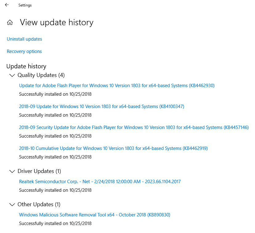

    We have a Windows 10 CD. So, we did an in place upgrade reinstall (keeping programs and files). When it was finished, that worked. We were online and all was working fine again. Then it downloaded Windows Updates: KB4462930, KB4100347, KB4457146, KB4462919, KB890830 and a Realtek Driver update 2023.66.1104.2017. See image below.

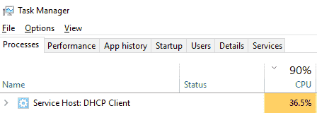

    After the restart, it would not get online again. Plugged ethernet cable in and tried. Disconnected and tried wireless. The DHCP Client pegs out. See image.

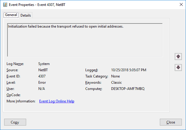

    Also, in the Event Viewer, we get a NetBT Event 4307 "Initialization failed because the transport refused to open initial address". See image.

    Did an in place upgrade install again. Once again, it was fixed and online. Set a restore point. Went online and it downloaded the same updates again, because the in place upgrade reverted the system. Restart. Will not go online again. Tried system restore to before Windows updates. Still will not get online.
