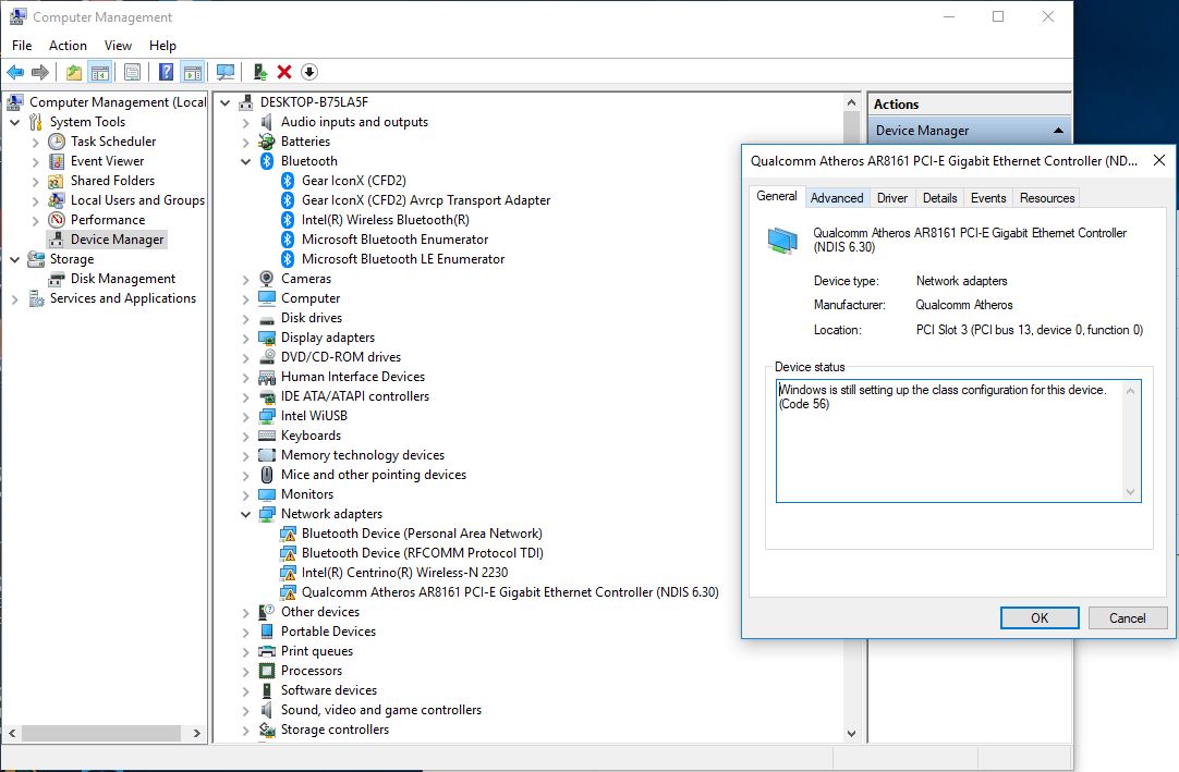

    Both my network cards ( wired and wireless) and my Bluetooth adapter shows the same error.
    How it happened:-
    i installed vm-ware and wanted to bridge the vm i created to my LAN adapter...but it threw an error saying that "there are no unbridged network adapters" this was odd as neither of my network adapters ave been bridged before, therefore i assumed reinstalling the drives of my adapters would help. but once i uninstalled the adapters and re-installed, this issue came up.
    stuff that i have tried:-
    1.Uninstalling vm ware and all my vpn apps
    2.downloading the latest drivers and installing
    3. plugging in an usb wifi card . (same error pops up in device manager when i plug it in)
    4. booting into safe mode with networking.
    5. running sysprep
    but i have had still no luck, i am quite sure that the problem is with windows other than my drives as i installed a fresh version of windows to another partition and booted from it..and everything worked.
    im a bit tech savvy so i dont mind if you get a bit technical with me but i would love it if i can get my adapters to work with out re installing windows ....a picture of the problem is attached below.

    One of the possible reasons why you are having an issue with the network adapter is because some components of the program may be corrupted and needs to update. To resolve your concern regarding the network issue, we suggest that you follow the steps below:
    Step 1: Run Network Adapter troubleshooter to scan and correct any possible cause of the issue.
    To do this, follow these steps:
    • Click Start, type Network settings > press Enter
      and click Status.
    • Under Network Status, click Network troubleshooter.
    • Follow the steps provided on the pop-up windows.
    • Once you're done, restart your device.
    If the issue still persists, follow the steps below:
    Step 2. Uninstall and reinstall the network driver to make sure that you will have the latest driver available for your device.
    • Press Windows key + X and select Device Manager.
    • Expand Network adapters.
    • Double-click on the device, and then click the Driver tab.
    • Click Uninstall, then OK.
    Download and install the latest version of network adapter driver on the manufacturer's website.
    On the other hand, the error 0x800706bb occurs when some files on the system are missing. To resolve this concern you may follow the steps provided in this
    link.
    Let us know if the solutions worked for you.
