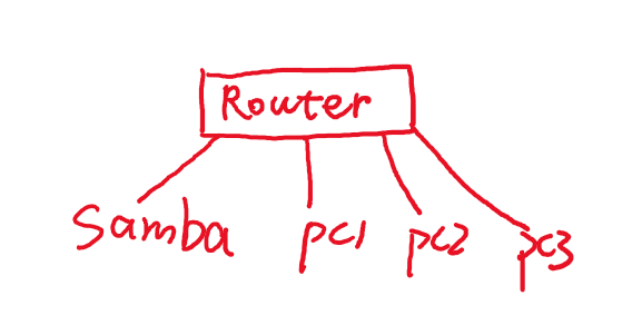

    The network topology is as follows:
    Network credential prompt while accessing a public share path hosted by samba 882f6531-8d67-4f75-99e3-ecffd4485507?upload=true.png
    1, samba server the share is public
    2, pc1 win10
    3, pc2 win10
    4, pc3 win10

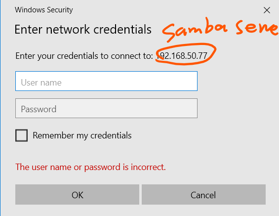

    While accessing samba server from pc1 and pc2, there is no network credential prompt.
    While accessing samba server from pc3, I will be prompted with the following popup box.
    Network credential prompt while accessing a public share path hosted by samba 16c52eb9-c429-4d44-85e4-dc43caaad320?upload=true.png
    I can give any valid character in the user name form and login successfully ofc, it should, cuz it's a public share .
    It is a little strange that why pc1, pc2 do not prompt, but pc3 prompt.
    I captured network traffic to check what happened there by wireshark, the capture result shows that both pc1 and pc2 would try logon on to samba by windows account after the message of NTLMSSP_NEGOTIATE, but pc3 would not try to logon on samba server, so win10 RST the connection and prompt the credential box.
    I checked windows credentials on pc1, pc2, pc3, there is no credential for the samba server.
    If a add a credential for samba on pc3 by windows credential manager, the prompt would not appearon pc1, pc2, I do not need to do this step
    Does any one know what the problem there ? I don't want to see the credential prompt, I don't want to add any credential to trick this problem either .
    Any suggestion is appreciate , Thanks.
