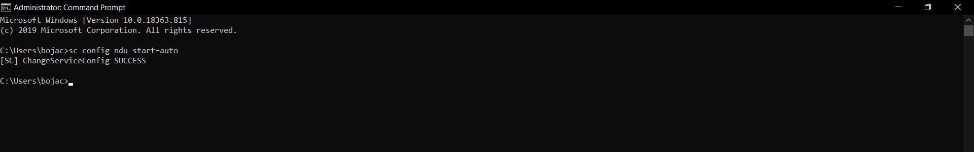

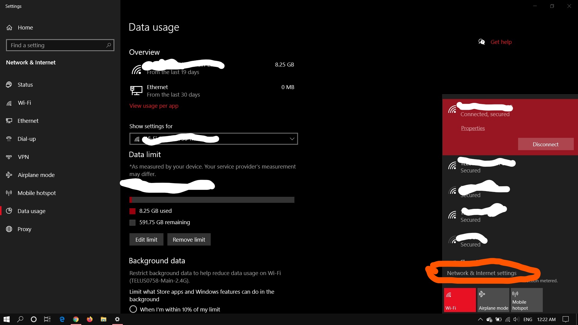

    Hello, I used to have this problem where the data usage would never count. Now I have it working smoothly through some research and would like to share that information to others as Microsoft hasn't addressed this issue. Some of you may not know that, you can view your network data usage in your settings, a neat little tool to keep track of your data plan consumption. Network Data Usage stuck at 0Mb 4450ba54-8991-4127-9b1d-605efe9ace66?upload=true.jpg So from my understanding, the "bug" was caused by other apps or drivers turning off the WIndows NDU Windows Network Data Usage Monitoring Driver. To turn it back on you must go on to Command Prompt CMD and type "sc config ndu start=auto" don't need the quotes
    Network Data Usage stuck at 0Mb 8efcd1bb-066b-457c-8b14-72698c499532?upload=true.png
    All credit goes to Codeit, from Super User.
    Source:https://superuser.com/questions/626073/how-to-make-windows-task-manager-to-show-network-usage
